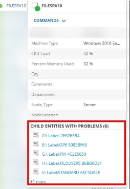

Volumes on servers are shown as state unknown after upgrading to 2025.1
After upgrading to version 2025.1, the monitored Volumes are shown as state unknown.
