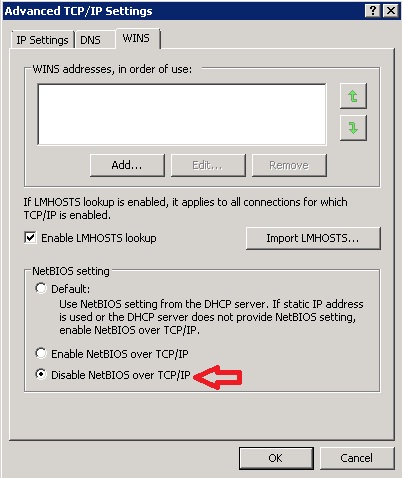

This article describes the topic about how Orion server uses Netbios (UDP 137) port to reach out to all the devices that are monitored by the Orion. There is an option to disable NetBios Over TCP/IP protocol and write an LMHOSTS file for the servers that need to be resolved using NB names. By doing so, it prevents NetBios Lookup Query to try and go through your firewall.

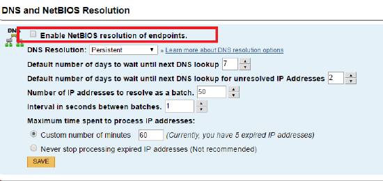

The correction to a point however pertains to this: NTA must be configured to allow the NetBios requests to be initiated and for it to be concurrent, it must be set to Persistent name resolution in the NTA settings. Easiest way to confirm is to go to NTA Settings, scroll down to DNS and NetBIOS Resolution and see if Enable NetBIOS resolution of endpoints is checked. Likely as well, the setting for DNS Resolution Option is set to Persistent as well.

I'd say your next method to test is to check the NTA Settings page, disable NetBios resolution if it's enabled, then see what happens when you restart the service.

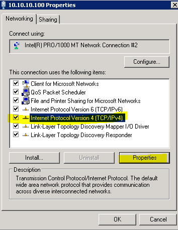

NetBIOS over TCP/IP is enabled in Internet Protocol Version 4 (TCP/IPv4)
  1.  Go to the Control Panel > Network and Sharing Center> Manage Network Connections.
    Note: be sure to disable on the NIC used by the Orion engine in case you have multiple NIC's.
  2.  Select the Interface and then right-click Properties.
Check NTA Settings to make sure NetBIOS is disabled:
