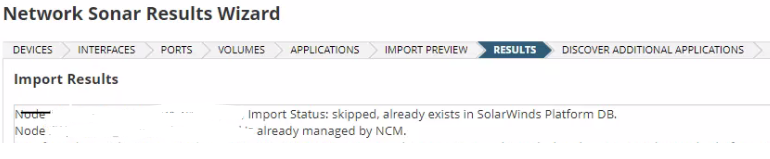

Error found in the web console when performing a network discovery:
Node xxxxx import status skipped, already exists in SolarWinds Platform DB.
Node xxxxx is already managed by NCM.

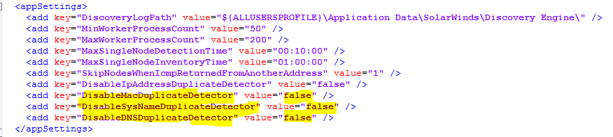

  1. RDP the main server and stop the services.
  2. Go to C:\Program Files (x86)\SolarWinds\Orion\ and edit the SolarWinds.Orion.Discovery.Job.dll.config in a Notepad as an admin.
  3. Scroll to bottom of the file and look for the following tags:
    <add key>="DisableMacDuplicateDetector" value="false" />
    <add key>="DisableSysNameDuplicateDetector" value="false" />
    <add key>="DisableDNSDuplicateDetector" value="false" />
  4. Change the values to True.
  5. Save the file and start the services.
  6. Run Network Discovery and verify that all undiscovered nodes are there.
Note: Revert to the previous (or default) setting if you experience issues caused by this change.

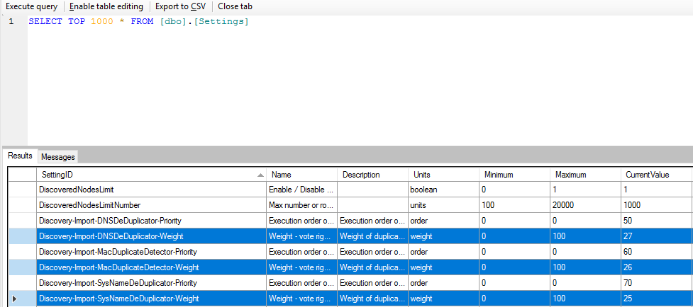

Resolution 2:
If this occurs during importing discovery results, this will occur still regardless of the first resolution since it is designed differently due to a calculation based on weights (e.g. in default: two devices have same sysname, but different MAC and DNS then it is not duplicate, etc
To view these settings (SysName, DNS and MAC) please follow these steps:
1. Connect to your SolarWinds Server.
2. Click on start and search for Database Manager.
3. Once the application is open, click on add Orion Server.
4. Navigate to Settings.
Screenshot of the settings table under Database Manager:
Discovery-Import-SysNameDeDuplicator-Weight 25
Discovery-Import-DNSDeDuplicator-Weight 27
Discovery-Import-MacDuplicateDetector-Weight 26
If you change the weight of the current value for one/any of these related items to 0, then duplicate detection will not occur for such item (sysname, dns or mac)
