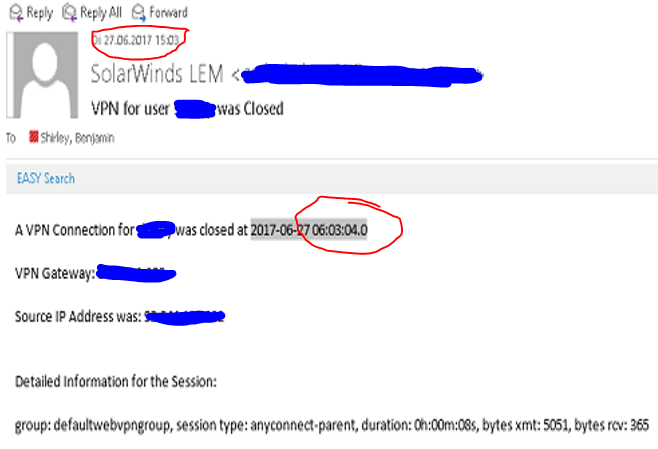

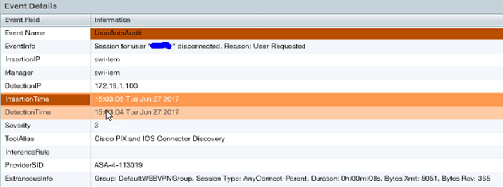

The SEM email alerts display a different detection time than what is displayed in the DetectionTime and InsertionTime fields of the event.
11/29/2018 11:00 PM
11/29/2018 11:00 PM
The Security Event Manager (formerly Log & Event Manager) email alerts display a different detection time than what is displayed in the DetectionTime and InsertionTime fields of the event as shown in the following example:
