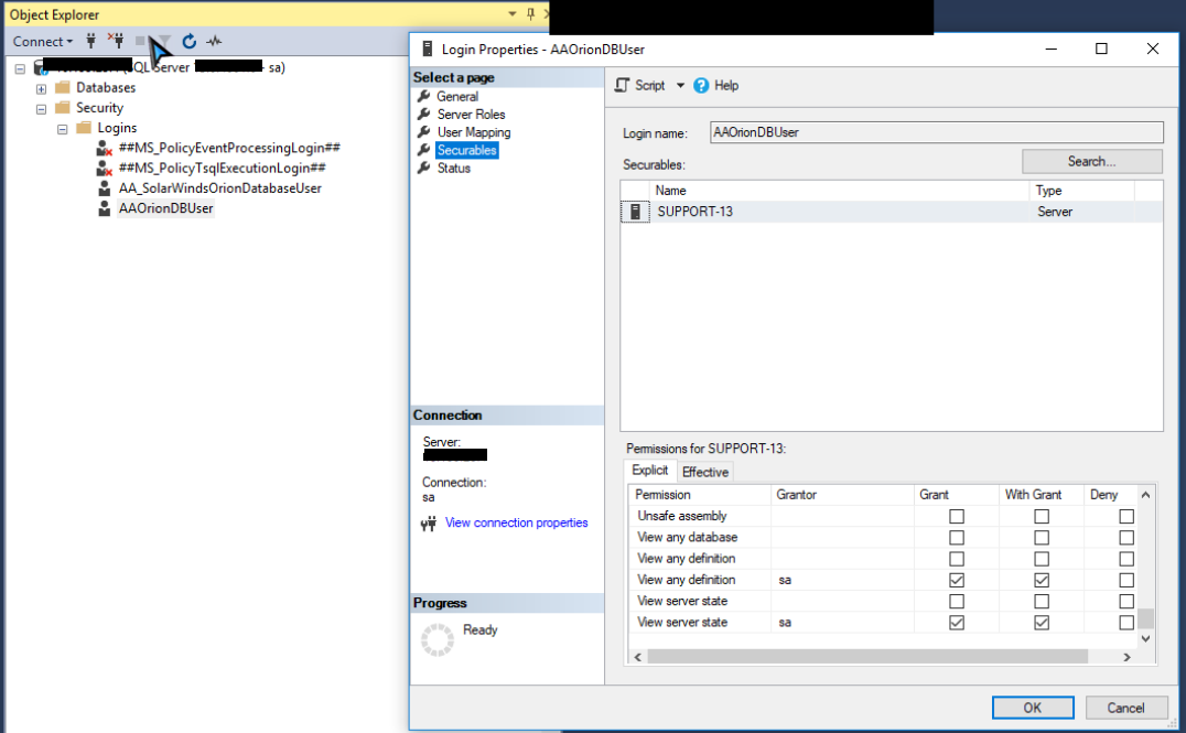

Steps to modify the account permission on the SQL database:
1. Connect to the database using SQL Server Management Studio
2. Navigate to the user accounts. Security>Logins>Locate the account used to manage the Orion database
3. Right-click the account and choose Properties.
4. Select the Securables page
5. In the bottom pane, scroll to the bottom and Grant - View Server State
The error should no longer be present when you run the diagnostic tool.
