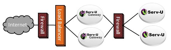

When you deploy a cluster of Serv-U Gateways, you need to:
  1. Define each Gateway on each Serv-U server (at the Server level)
  2. Define listeners on BOTH Gateways (at the Domain level)
Serv-U does not currently load-balance ports on the Gateway itself, so you need to declare different ports on each Serv-U Gateway listener and then use your load balancer to address the entire pool.

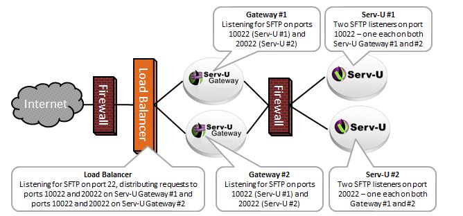

For example, to set up SFTP in this configuration:
...you would use a configuration like the following.
  1. Add Gateway#1 and Gateway#2 on Serv-U#1
  2. Add Gateway#1 and Gateway#2 on Serv-U#2
  3. Go into your domain on Serv-U#1 and add TWO new listeners:
    • SFTP on Gateway#1 on port 10022 (or any other port)
    • SFTP on Gateway#2 on port 10022
  4. Go into your domain on Serv-U#2 and add TWO more new listeners:
    • SFTP on Gateway#1 on port 20022
    • SFTP on Gateway#2 on port 20022
  5. Go into your load balancer and configure the following round-robin pool to handle incoming connections on port 22:
    • Port 10022 on Gateway#1
    • Port 20022 on Gateway#1
    • Port 10022 on Gateway#2
    • Port 20022 on Gateway#2

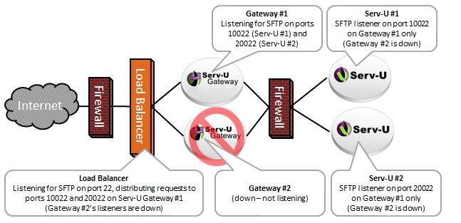

One Gateway Fails
In this scenario, one of the Serv-U Gateways fails. The load balancer notices the two missing ports from the dead gateway and withdraws them from the load balancing pool. From the perspective of end users, service continues.

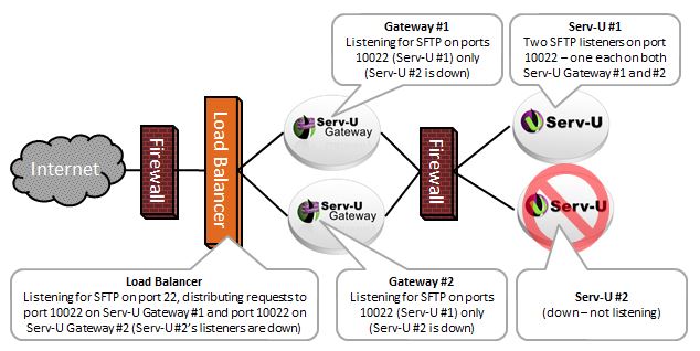

One Server Fails
In this scenario, one of the Serv-U servers fails. This causes the Serv-U Gateways to shut down their related ports. Then, the load balancer notices the missing port from each gateway and withdraws them from the load balancing pool. From the perspective of end users, service continues.

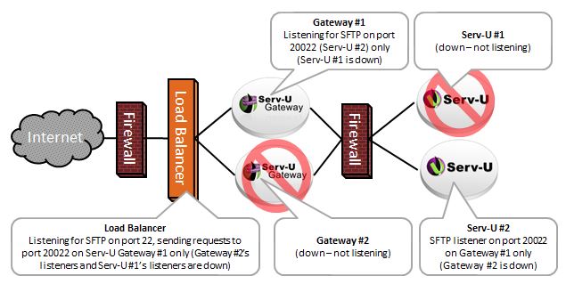

One Server and One Gateway Fail
In this scenario, one of the Serv-U servers fails and one of the Serv-U Gateways fails. This loss of the Serv-U server causes the surviving Serv-U Gateway to shut down its related ports. Now, the load balancer notices that all ports are inactive except one and begins to send all traffic to the single surviving port. From the perspective of end users, service continues.
