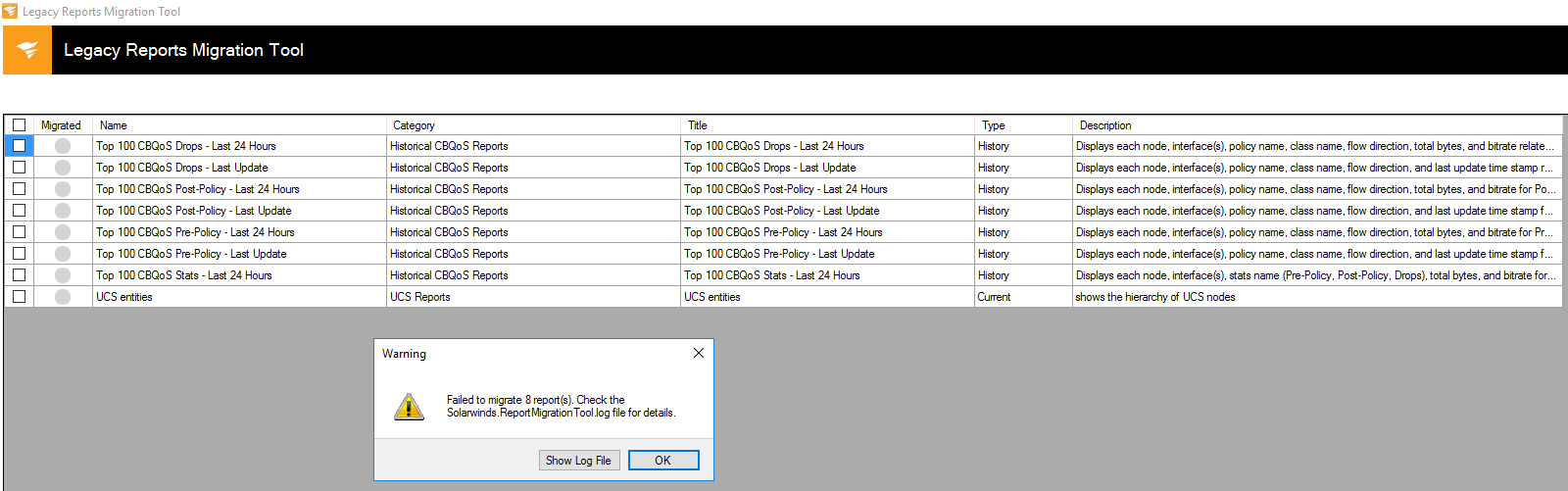

You will see this error when upgrading, forcing you to do migrate the legacy reports.
"Failed to migrate report(s). Check the Solarwinds.ReportMigrationTool.log file for details."
Failed to migrate report(s). Check the Solarwinds.ReportMigrationTool.log file for details.png

  1. First, try to migrate ALL the legacy reports through the migration tool.

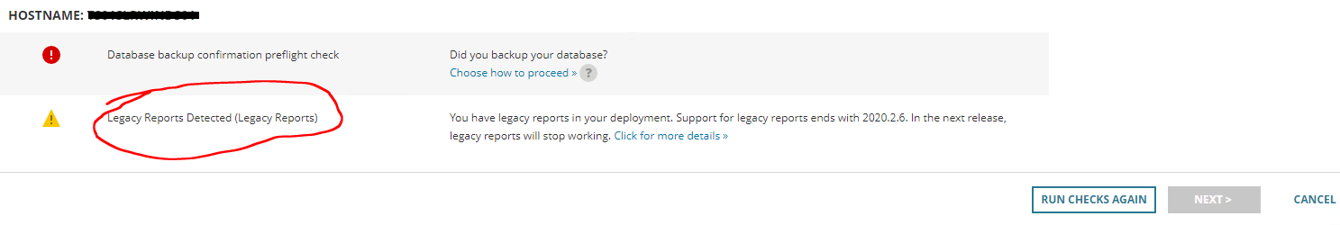

Please note: The migration tool will not make the warning in the SolarWinds Active Diagnostics go away until the remaining steps are followed.
  1. Optional: Delete the reports folder. Default location C:\Program Files (x86)\SolarWinds\Orion\Reports
  2. Run SQL script to delete all the legacy reports saved in the default location.
Delete from ReportDefinitions where LegacyPath = '\Reports'
  1. Try rerunning the installer checker again. The legacy report warning will be gone now.
