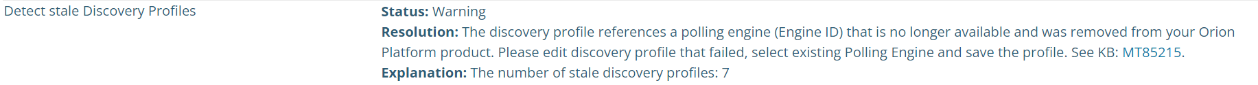

Running the Active Diagnostics shows the issue below:
Status: Warning
Resolution: The discovery profile references a polling engine (Engine ID) that is no longer available and was removed from your Orion Platform product. Please edit discovery profile that failed, select existing Polling Engine and save the profile. See KB: MT85215.
Explanation: The number of stale discovery profiles:
