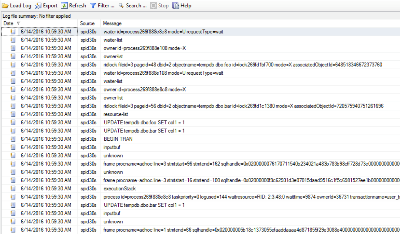

Trace Flags
Historically, deadlocks were captured in the SQL error log through the use of trace flags 1204 or 1222 using syntax (© 2018 Microsoft, Inc., available at https://docs.microsoft.com, obtained on Nov 7, 2018) similar to the following:
DBCC TRACEON (1222, -1)
The output to the SQL error log will look like this:

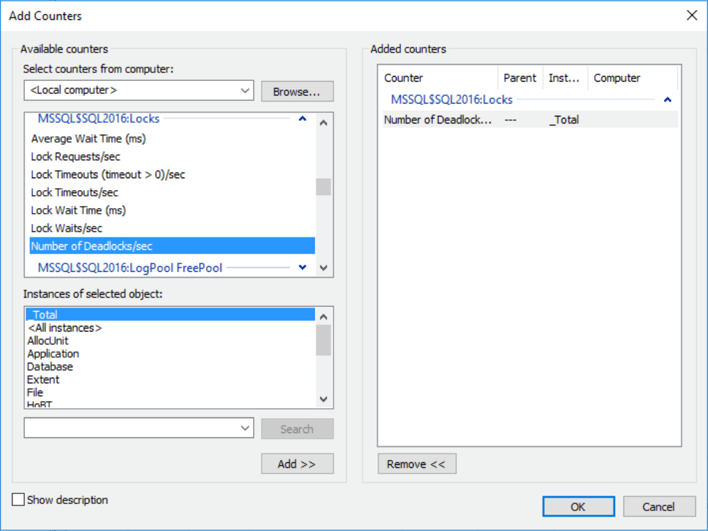

Performance Monitor
There is a performance counter available for showing the number of deadlocks happening. Inside the SQL Server:Locks object. The counter name is Number of Deadlocks/sec, and you can return the total number for the instance.

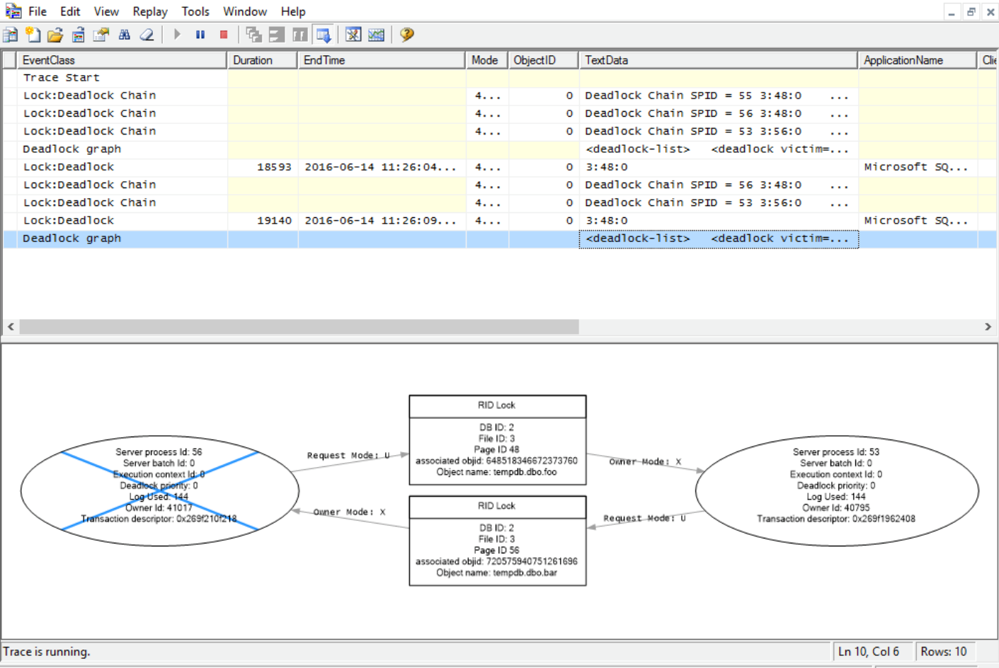

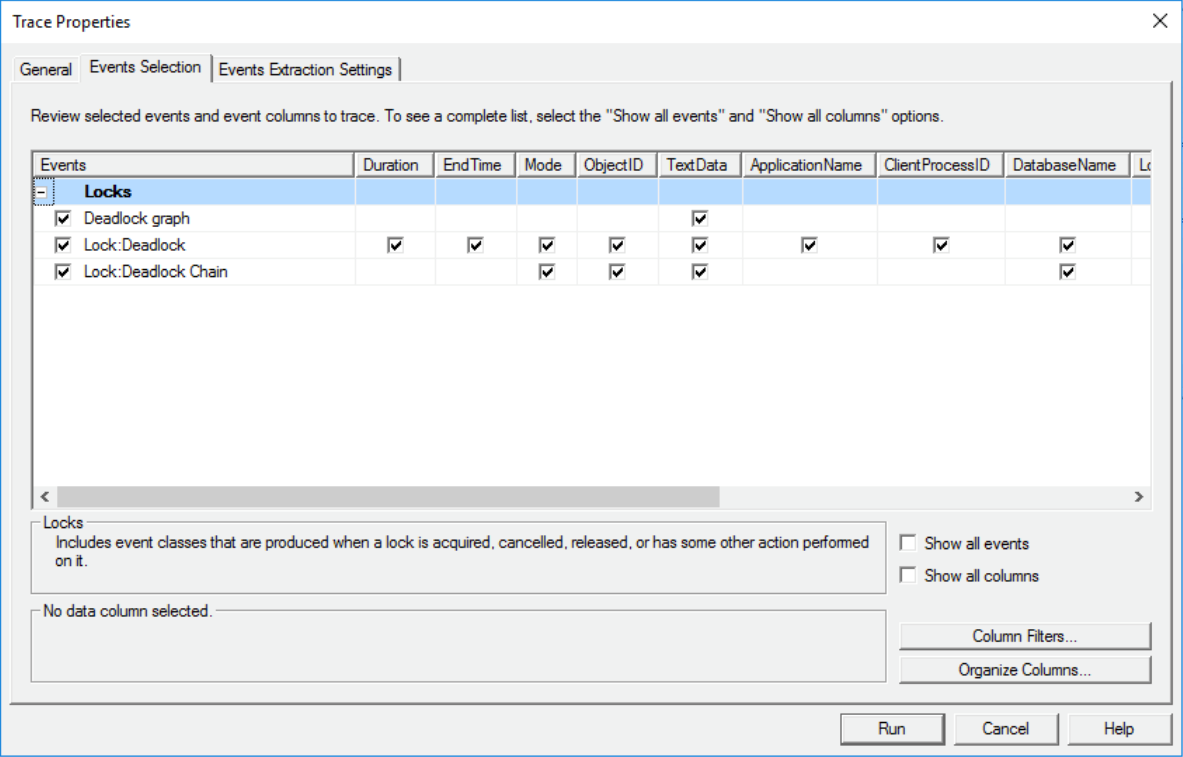

SQL Server Profiler
You can use SQL Server Profiler (or a server side trace) to capture the deadlock details. The trace event class is Locks, and the event name is Deadlock Graph. The trace will then capture the deadlock details and display them in an XML graph:

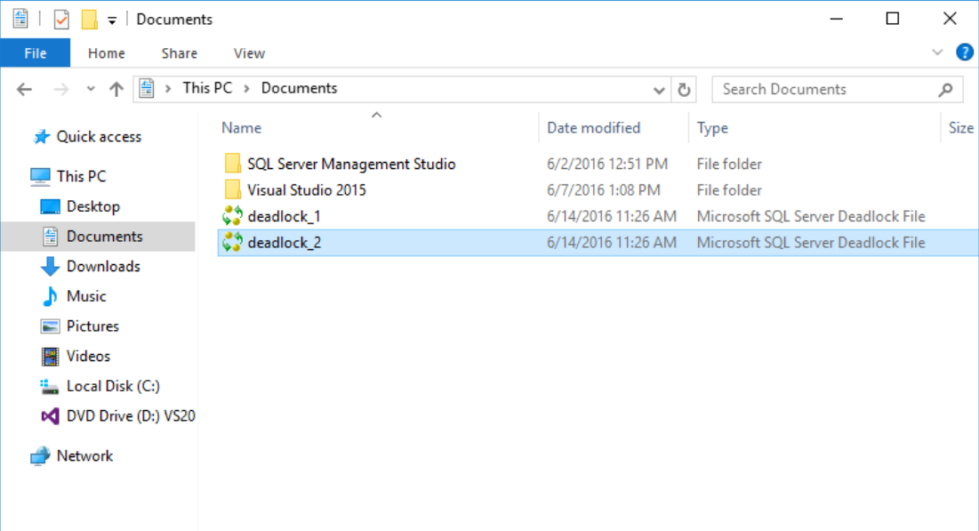

You can also configure the trace to capture the deadlock details as distinct files that you can open with SQL Server Management Studio (SSMS).
Now the trace will output the deadlock files to the location you have defined:
Similar to trace flags, using a server trace requires you to have the trace running at all times, making it hard to proactively capture deadlock details.

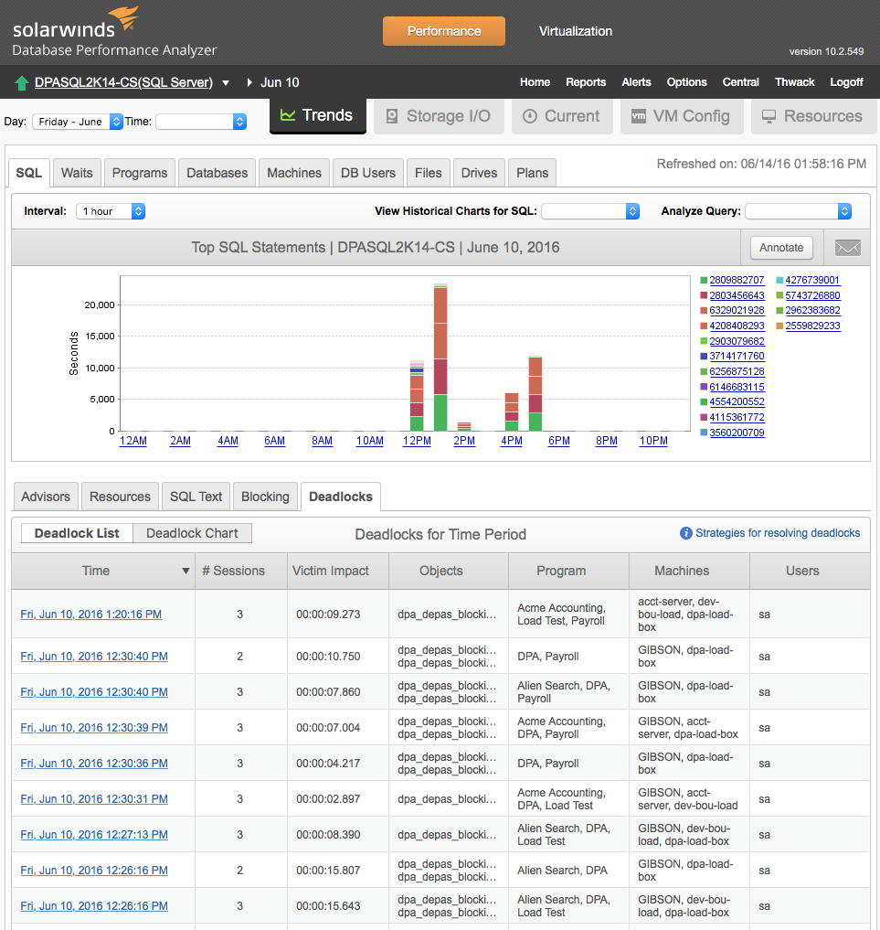

Use DPA to find deadlocks
You can also use Database Performance Analyzer (DPA) to capture and examine deadlocks.
DPA uses a modified Extended Event session in order to capture deadlock details for SQL Server, and it uses the default system health session for Amazon RDS. Users are able to configure a non-default session using the Advanced Properties page. When deadlocks are detected, they are displayed at the bottom of the Trends tab:
This tab displays details about deadlocks, including the time the deadlock happened, the number of sessions involved in the deadlock, the objects involved, the program name, the machine name, and the user name. DPA also shows a metric named Victim Impact, which is a measure of time the deadlocked transaction was running and consuming resources. The transaction time of the deadlock victim is a waste of time and resources, making this a good measure of the impact the deadlock had on the application and the end-user.
In terms of performance loss due to deadlocks, eliminating the deadlocks with the highest victim impact (or groups of similar deadlocks with the highest cumulative victim impact) results in the greatest performance improvement for the application and the end-user.
During deadlock resolution, victim transactions are rolled back, causing the work of the session to be undone, and in many cases requiring entire transactions to be re-run. The rework caused by deadlocks is a hidden performance cost. The transaction time of the victim (which is wasted time) can be viewed as a good measure of the incurred performance cost.
For an entire deadlock, the Victim Impact is calculated by taking the sum of transaction times for all deadlock victims.

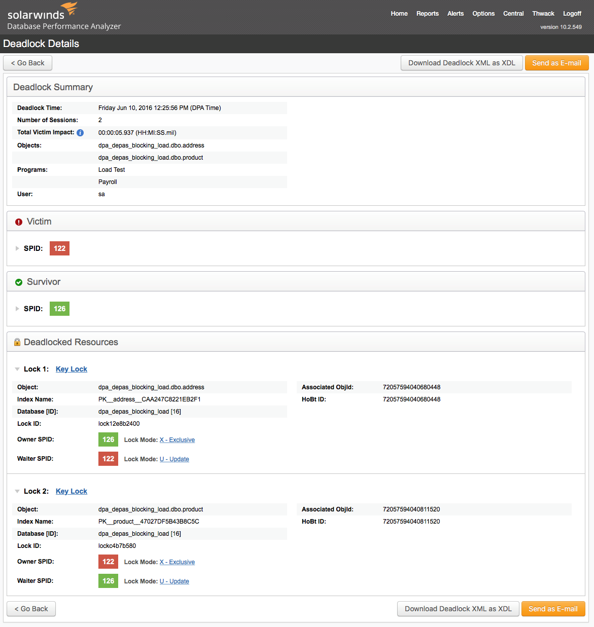

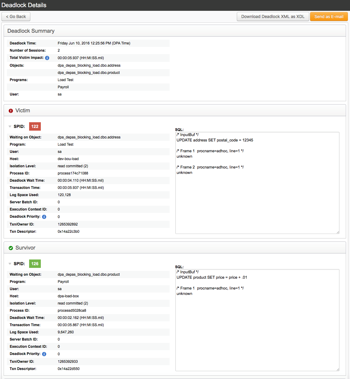

Click the links on the left to open the Deadlock Details page where you can view the deadlock summary showing the deadlock victim and survivor:
Scroll down the Deadlock Details page to find information on the deadlocked resources:
At the top (and bottom) right of the screen you see two buttons. One button allows you to download the deadlock details as an XDL file to be used with SQL Server Management Studio for viewing the deadlock graph. The other button allows you to send the deadlock details as an email and include the XDL file as an attachment.

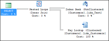

Using a covering index can reduce the chance of a deadlock caused by bookmark lookups. Bookmark lookups can be identified inside of a query plan by this icon:
If your queries use bookmark lookups and are seeing deadlocks, try using a covering index to remove the bookmark lookup.
