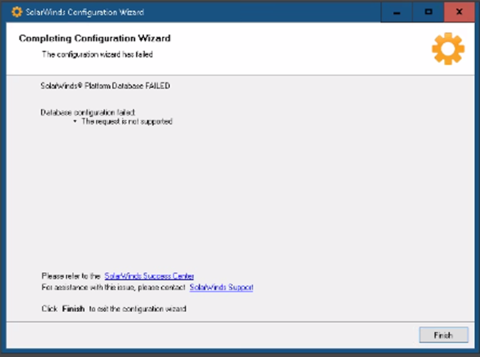

"Database configuration failed. The request is not supported." error in Configuration Wizard on the SolarWinds Platform
This article provides the step-by-step resolution in resolving the error on the Configuration Wizard for SolarWinds Platform Database FAILED. Database configuration failed. The request is not supported.

The Configuration Wizard for SolarWinds Platform Database FAILED. Database configuration failed.
