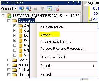

  5. Return to SQL Server Management Studio or Orion Database Manager, right-click your SQL server, and select Attach Database.

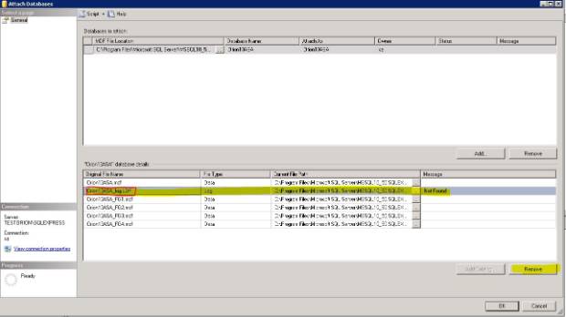

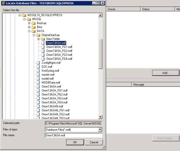

  6. Select the MDF file, and click OK.
  7. Remove the LDF file entry and click OK.
