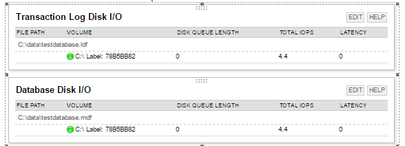

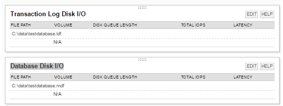

In AppInsight for SQL Server, the resources for Database Disk I/O and Transaction Log I/O shows no data.

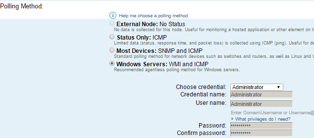

  1. Go to the node in question in the Orion server under Settings > Manage nodes.
    Note: The polling method must be set to WMI.

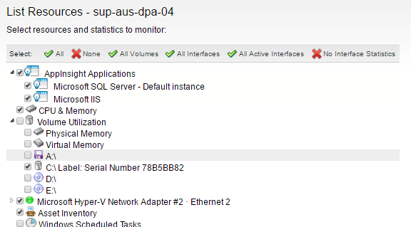

  2. On the node screen, click List resources.
    Note: Any volumes containing the database data files and log files must be selected for monitoring.
