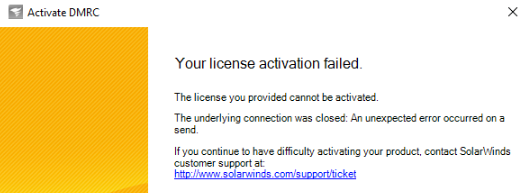

When activating a valid license online, it fails with the following error message on DMRC:
ERROR
Your license activation failed
The license you provided cannot be activated.
The underlying connection was closed: An unexpected error occurred on a send.
The request was aborted. Could not create SSL/TSL secure channel

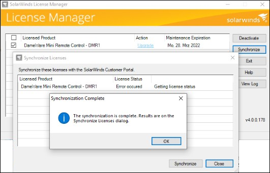

    SolarWinds License Manager also reports an error status:
    ERROR
    The synchronization is complete. Results are on the Synchronize Licenses dialog.
