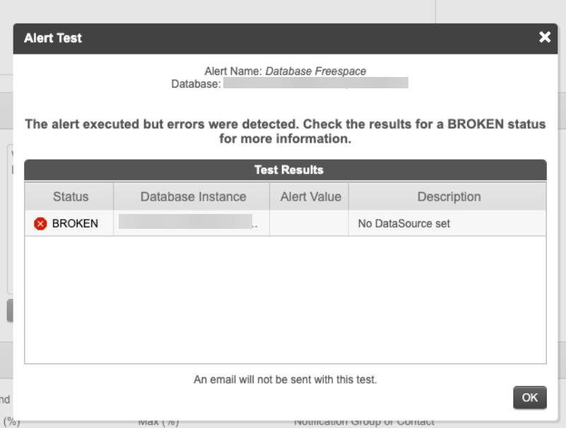

The Database freespace alert status will be seen as broken after upgrading to DPA 2024.2. This alert is supported for SQL Server, Azure SQL DB, ASMI, Sybase, Db2 database.
Currently, it is working only for Db2 and Sybase Database.

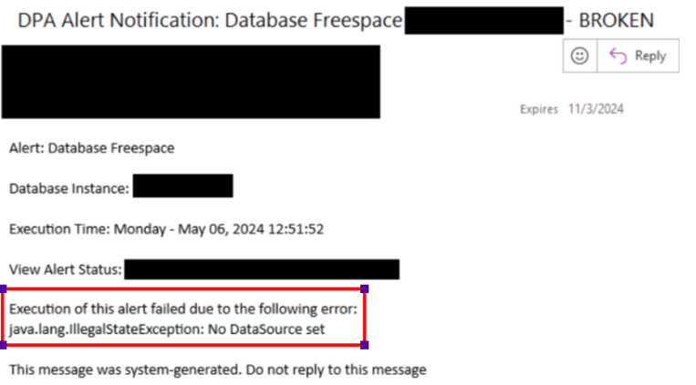

Execution of this alert failed due to the following error:
java.lang.illegalStateException: No DataSource set
