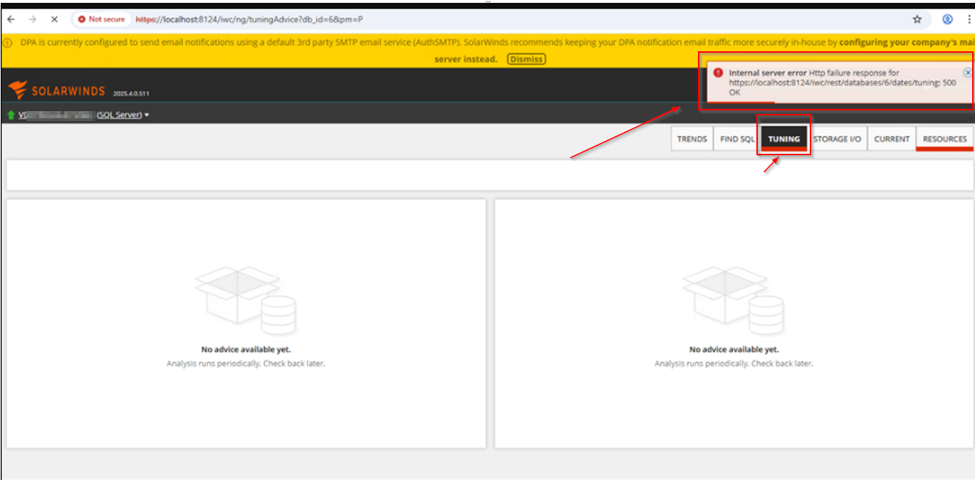

In DPA 2025.4, opening the Tuning tab for affected monitored databases on a SQL Server repository can fail with HTTP 500 due to an "Invalid column name 'table_id'" error against table CON_IA_TABLE_SUMMARY_{dbid}. The issue was fixed in DPA 2026.2, and upgrading to 2026.2 or later resolves the problem.
When a user clicks the Tuning tab for certain databases in DPA 2025.4, the UI displays "Internal server error Http failure response for /iwc/rest/databases/{id}/dates/tuning: 500 OK" and no tuning advice is shown. In idc.log, the backend query joining CON_FQ_OBJECT_{dbid} and CON_IA_TABLE_SUMMARY_{dbid} fails with SQLServerException "Invalid column name 'table_id'", which is wrapped in a DpaException and returns as HTTP 500 on the Tuning endpoint.

This issue is fixed in DPA 2026.2 so that the Tuning tab correctly reads Index Analysis data from CON_IA_TABLE_SUMMARY_{dbid} without raising the "Invalid column name 'table_id'" error.
To resolve the issue, upgrade the affected DPA 2025.4 instance to DPA 2026.2 or later. After the upgrade, the Tuning tab loads normally and displays tuning recommendations using the existing repository data.
