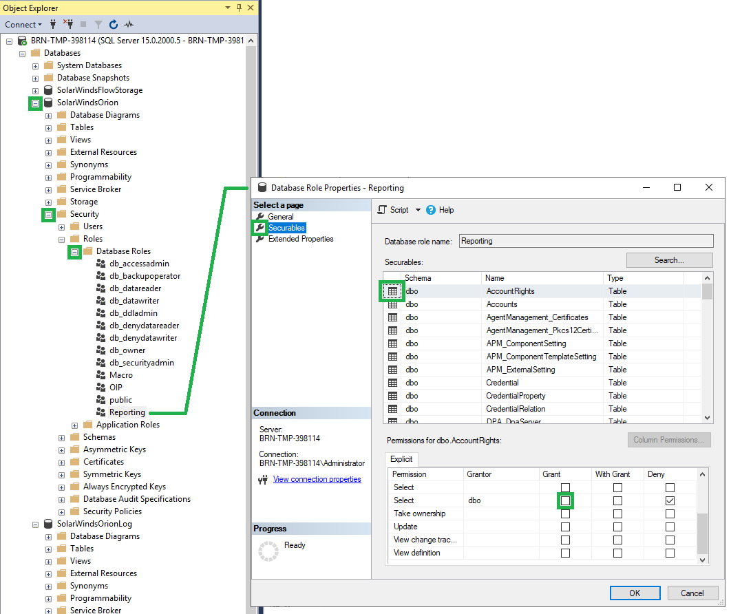

  1. Using MS SQL Studio, log in to your database server as an administrator.
  2. Navigate to SolarWindsOrion > Security > Roles > Database Roles > Reporting.
  3. Right-click the Reporting role
  4. Select Properties
  5. In the popup window, click Securables, and then select the table you want to access. For example, the picture below shows how to select the AccountRights table.
  6. In the Permissions for dbo.<table name> are, select the the box in the Grant column
  7. Click OK.
The report will now be executed correctly. If the table used by the custom SQL in the report is on a different database, such as Flow Storage, Log Analyzer Database, or another custom database, See KB NR2.
Alternatively, you can also use the SolarWinds Database Manager and grant the privileges by running the following SQL Query.
In the code, replace Accounts with the name of the table you need the SQL report to access.
GRANT SELECT ON [dbo].[Accounts] TO [Reporting]
