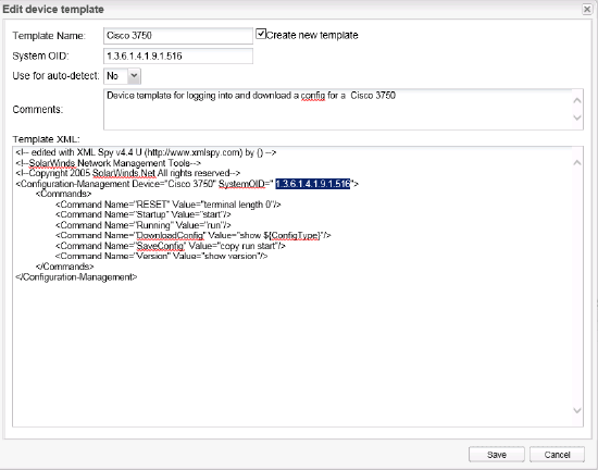

Complete the task and save the work
Open the copy of the generic template we started with.
  • For the Template Name in NCM 7.4, put a check in the box for Create a new Template.
  • Enter the Template Name:  Cisco 3750
  • Enter the system OID: 1.3.6.1.4.1.9.1.516
  • For Auto Determine:
    • If you want this device template to apply to all devices where the OID will match, then we recommend using auto determine.
    • If it is a template for a unique device that may still match the common OID, append the real OID with a number not likely to exist like 1.3.6.1.4.1.9.1.516.9988.9988 and not use auto determine. This would require that you manually assign the device template to the device in NCM settings in the communication sections.
What you would have, is something like this:
Click save at the bottom right and the new template is ready to be used.
