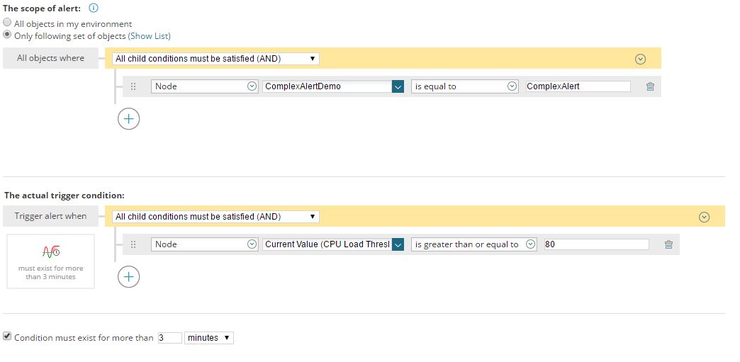

For this example, you will need to create a custom property and apply to the nodes which you would like to include in the alert. This will give us a unique reference point to use to create the scope of our Alert.
See Create a custom property for more information.
Tip: To learn about using SQL queries on AlertDefinitionsView, see Quick way to look through all alert trigger definitions for a customer property in THWACK.
For this example, the custom property created is called ComplexAlertDemo and is applied to 3 or 4 nodes.

- Under the Trigger Condition tab is where we are going to set the Alert Condition:
- Once the alert is configured, enable the "Complex Condition" option. This needs to be configured so that the alert will not trigger until 3 or more devices are exceeding the CPU threshold defined in the alert.

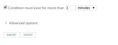

- Expand the Advanced Option at the bottom of the page.
- Select the box and expand to "Enable Complex Conditions".
- A new field will appear here you can enter the minimum number of devices which matches the trigger condition before the trigger action is executed.
