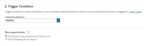

  3. Set the following conditions under the Trigger Condition tab:
    • I want to alert on: Interface
    • The Scope of alert: All objects in my environment

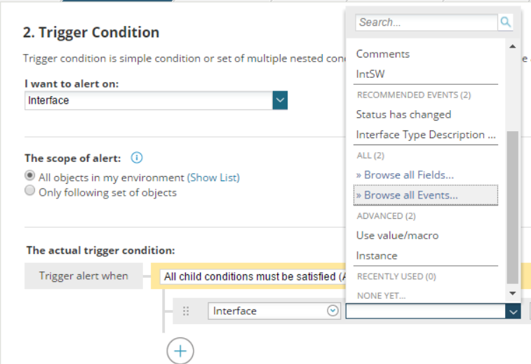

  4. In The Actual Trigger Condition, click Browse all Events.

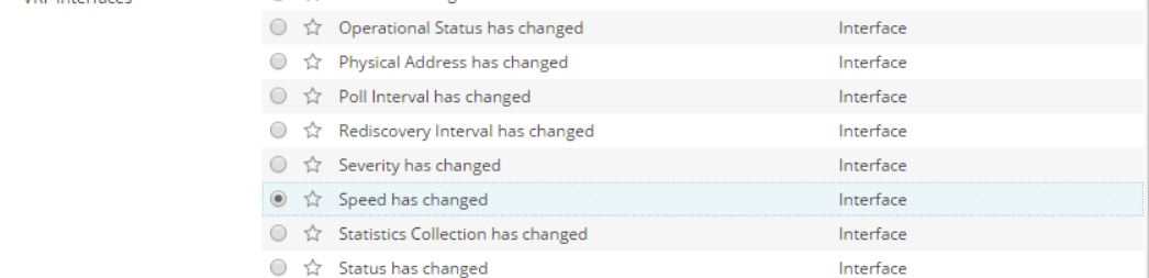

  5. Select Speed has changed under the Database column name.

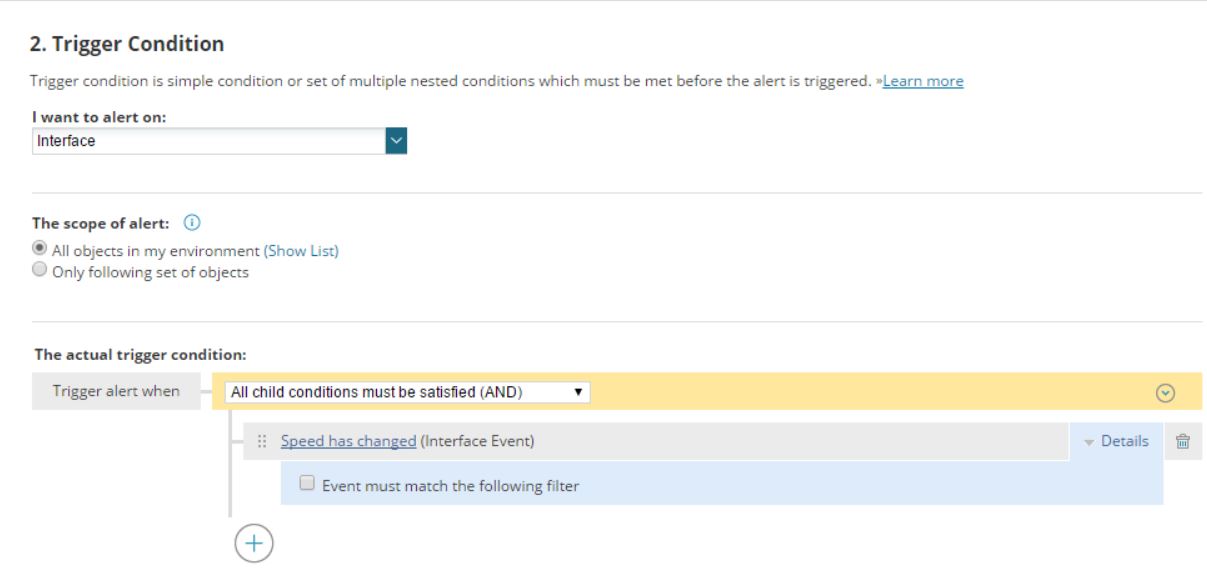

  6. The Trigger Condition will look like the following:
