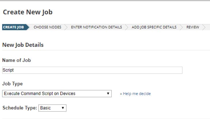

  3. Click Create New Job.
  4. Under Job Type, select Execute Command Script on Devices.

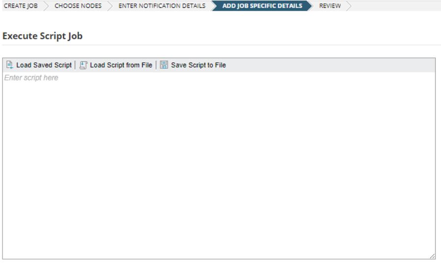

  8. Enter the script in the Execute Script Job field:
