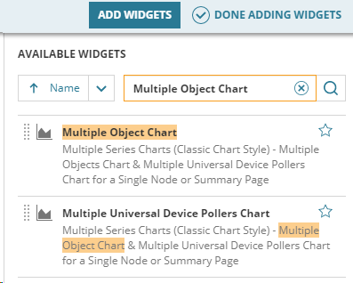

  3. Click Add Widgets at the top right side and search for the Multiple Object Chart:

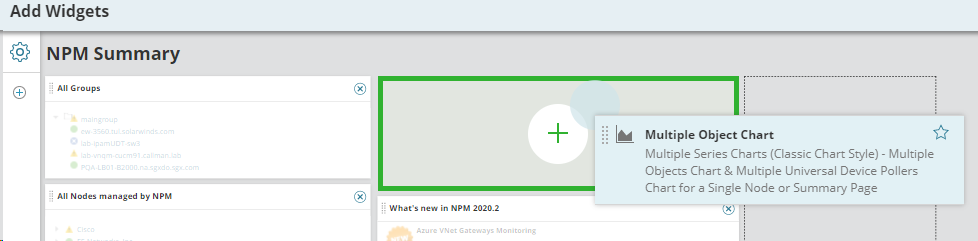

  4. Drag and drop the widget to the desire position and click Done adding widget at the top right side:

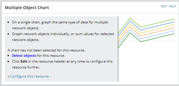

  5. Click Configure Resource from new widget:

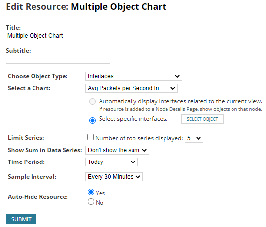

  6. Select the Object Type, Type of Chart, Data Series, Time Period, Sample Interval according to the requirement and the option to Auto-Hide the resource, e.g:

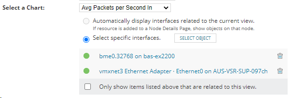

  7. Click Select Object to select the target object if you wish to show only specific object, e.g. Interface:

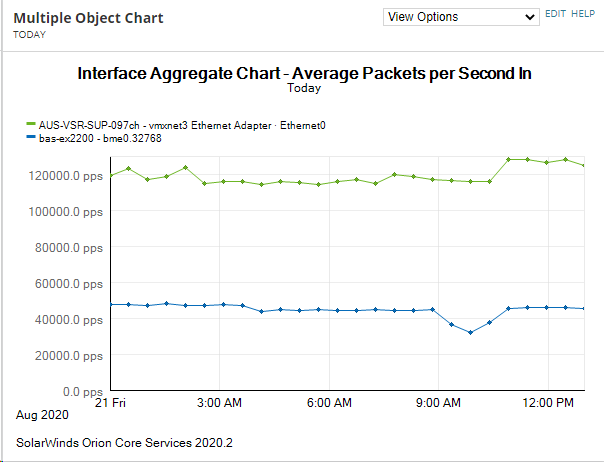

  8. Once you have filled in the desired options, click Submit and it will graph out the data you have selected, e.g:
