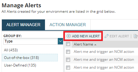

  1. Log in to the Orion Web Console.
  2. Click Settings > All Settings.
  3. Under Alerts & Reports, click Manage Alerts.
  4. In the Manage Alerts page, click Add New Alert.
  5. Complete the Add New Alert tab pages to create the new alert.

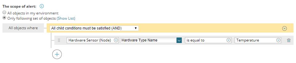

    When prompted, select the following settings:
    1. Click the drop-down menu and select Hardware Sensor (Node).
    2. Set the alert scope to only choose objects where Hardware Sensor (Node) Hardware Type Name is equal to Temperature (or select the sensor type your require such as battery, CPU, disk, fan, power supply, etc).
      Feel free to add another scope if you need to set a specific temperature sensor you need to configure the alert.
    3. Set the trigger condition.
      For example, Hardware Sensor (Node) Status Description is equal to Critical.
