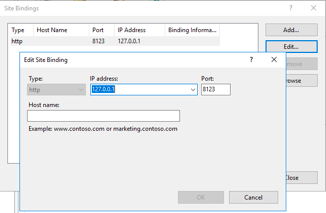

  7. Right-click the ‘Report Scheduler’ website and select ‘Edit Bindings’.
  8. Select the binding from the list and click ‘Edit’.
  9. In the ‘IP address’ field enter ‘127.0.0.1’ to bind the website to the loopback adapter.
  10. In the ‘Port’ field, enter an unused port between 1 and 65535 and click 'OK' to save changes.
  11. Click ‘Close’ to close the ‘Site Bindings’ window.

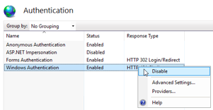

  12. Select ‘Report Scheduler’ from the list of websites and click ‘Authentication’ from the ‘Report Scheduler home’.
  13. Under ‘Authentication’, ensure that ‘Anonymous Authentication’ and ‘Forms Authentication’ are the only methods enabled. Right-click any other authentication types and select Disable.

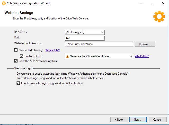

  1. Re-run the website portion of the Configuration Wizard.
    • This time, set your configuration options for users who will be accessing the SolarWinds Platform Web interface using CAC authentication, e.g., binding on all unassigned interfaces, TCP port 443, Windows Integrated Auth, etc.
    • Ensure the Website Root Directory is different than the Report Scheduler path specified in step 1 (for example, C:\inetpub\SolarWinds).
    • If you are unable to edit the 'IP Address' and 'Port' fields, uncheck 'Skip website binding'.
    • If HTTPS should be enabled on your primary SolarWinds Platform website, enable it here and select the certificate to be used for encryption from the certificate drop down.
  2. Note* if you are on version 2022.x or later you need to repair the entire Platform, not just run the Configuration Wizard.
  3. Walk through the remaining steps in the Configuration Wizard by clicking 'Next. Once complete, you should now have two independent SolarWinds Platform websites running: one bound exclusively to the loopback interface using forms-based authentication for use with the Report Writer, and an additional website accessible to end users using CAC card authentication.

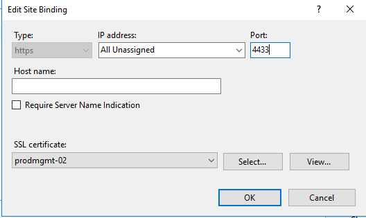

  2. Right-click the ‘Report Scheduler’ website and select ‘Edit Bindings’
  1. In the 'Site Bindings' window, click the 'Add' button to create a new binding.
  2. In the 'Type' drop-down, select 'https'.
  3. In the ‘IP address’ field, enter ‘127.0.0.1’ to bind the website to the loopback adapter.
  4. In the ‘Port’ field, enter an unused port between 1 and 65535, and click ‘OK’ to save changes.
  5. Click the 'SSL certificate' drop down and select the certificate that will be used to encrypt traffic to this website.
  1. When done click 'OK' to save changes.
  2. From the 'Site Bindings' window select the 'http' binding and click 'Remove'.
  3. When done click 'Close' to save changes.

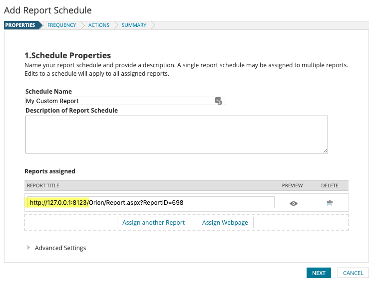

  1. Log in to the SolarWinds Platform Web interface, navigate to the report or view you want to be sent on a scheduled basis, and copy the URL to your clipboard or Notepad.
  2. Navigate to the Report Scheduler located under Reports > All Reports > Manage Reports > Schedule Manager.
  3. Click 'Create New Schedule'.
  4. Enter a name for the schedule and provide an optional description of the report that this schedule will generate.
  5. Click the 'Assign Webpage' button.
  6. Paste the URL you copied in step 1 to the Reports assigned field.
  7. Edit the URL to reflect the IP address 127.0.0.1 and the TCP port you defined when creating the Report Scheduler website in IIS above.
  1. Click 'Next' and then click 'OK' on the dialog window that appears notifying you that the URL entered is not the same URL that is currently being used to access the SolarWinds Platform Web interface.
