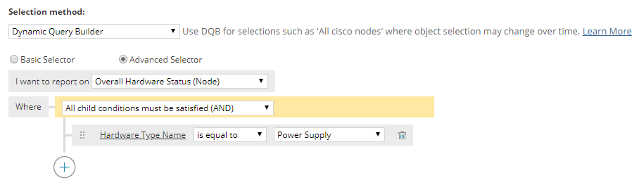

  4. In the Layout Builder tab, under Content, click Edit next to the For All Overall Hardware Statuses (Node) drop-down menu.
  5. In the Add Content dialog, select Advanced Selector, and click Add Condition.
  6. In the Where drop-down, select All child conditions must be satisfied (AND).
  7. Click Select field..., search for and select Hardware Type Name, and click Add column.
  8. In the Add content dialog, select is equal to in the first drop-down and Power Supply in the next.
  9. You may change the Hardware Type Name value  according to the desired ones such as Fan.Temp etc
  10. Click Add to Layout and save the report.
