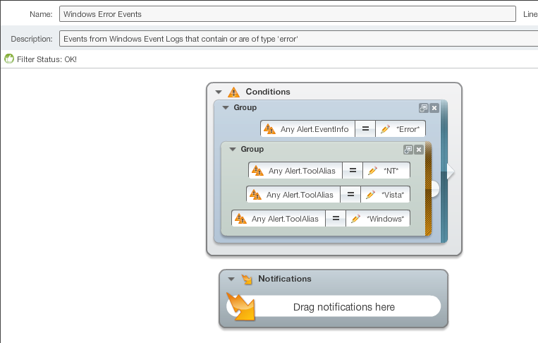

  9. The end result should look as follows:
  10. Click Save. The new filter appears in the list of filters on the left side of the Monitor page.
