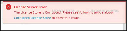

When you access the License Manager in the SolarWinds Web Console, an error message appears saying the License Store is corrupted.
This article describes how to resolve the following error (License store is corrupted) displayed when you access the License Manager (Orion Platform 2019.4 and later) in the SolarWinds Web Console after a recent migration/move of SolarWinds Platform to the new server.

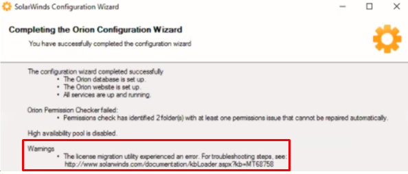

In some cases, the Configuration Wizard finishes with the following error/warning:WarningsThe License Migration Utility experienced an error. For troubleshooting steps. see ...

License Server Error. The License Store is Corrupted.

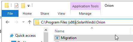

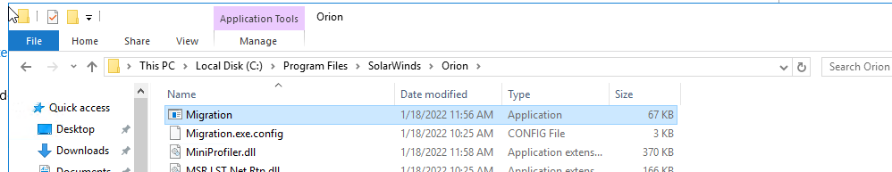

- Migration.exe can be found in the following directory:
- C:\Program Files (x86)\SolarWinds\Orion (for older installations)
- C:\Program Files\SolarWinds\Orion
To reset the license store:
The default location is at C:\Program Files\SolarWinds\Orion:
