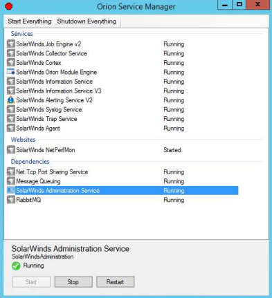

Is the SolarWinds Administration Service running on the Main Polling engine?
  1. On the scalability engine server, open the Orion Service Manager.
  2. Verify that the SolarWinds Administration Service is running.
  1. If the service is not running, select it and click Start.
