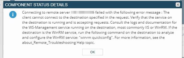

A SAM component monitor returns the following error: Connecting to remote server failed with the following error message: WinRM cannot complete the operation. Verify that the specified computer name is valid, that the computer is accessible over the network, and that a firewall exception for the WinRM service is enabled and allows access from this computer. By default, the WinRM firewall exception for public profiles limits remote computers' access within the same local subnet. AppInsight for IIS, AppInsight for Exchange, PowerShell component monitors are not polling - unknown status. Server Configuration Failed. An error occurred during server configuration (Error code: 255). The extended attributes are inconsistent. WinRM poling failed.
Connecting to remote server failed with the following error message : WinRM cannot complete the operation. Verify that the specified
enabled and allows access from this computer. By default, the WinRM firewall exception for public profiles limits access to remote
computers within the same local subnet.

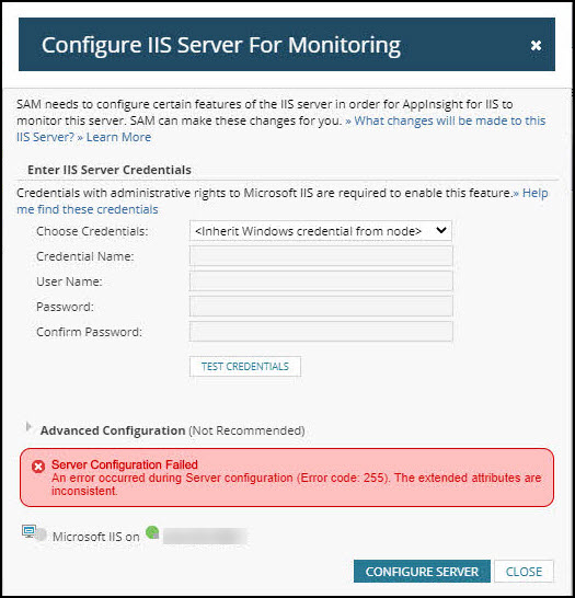

You may also receive the following message when attempting to enter the application details page for the first time.

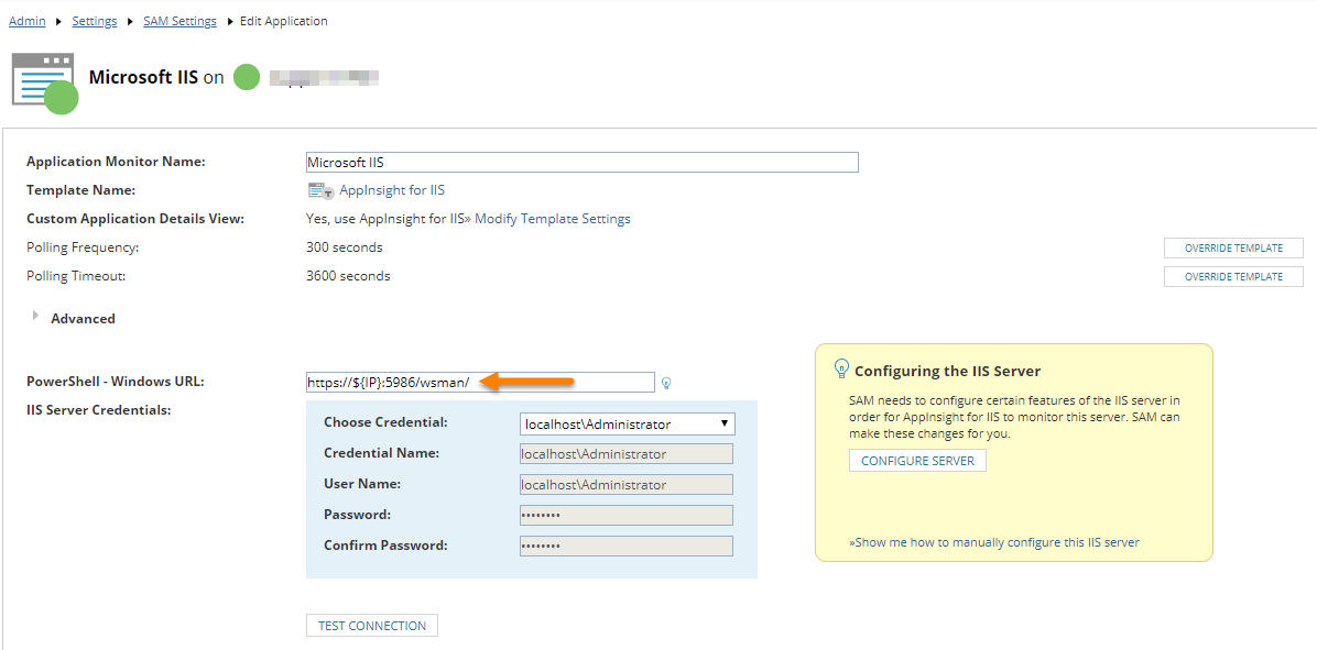

To change the HTTPS listener type, edit the application monitor (Go to the Application Details page > Edit application monitor in the upper right or the Management resource). Change the PowerShell- Windows URL from the default (https://${IP}:5986/wsman/) to the HTTP listener (http://${IP}:5985/wsman/) if you have not built an HTTPS listener in the article above.
