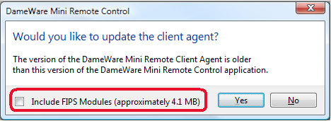

    • During an update of the Client Agent Service (on the fly):

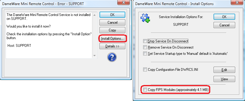

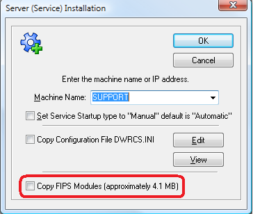

    • During the initial installation of the Client Agent Service via the File/Install Service menu in Dameware MRC:
    • During the initial installation of the Client Agent Service (on the fly):

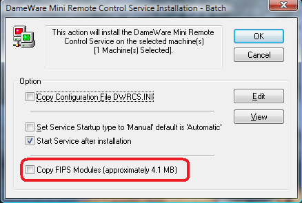

    • Via the Dameware NT Utilities (DNTU) software, via the Batch pane in the Services View:

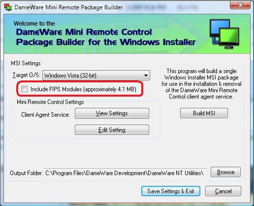

    • Via the Dameware MSI Builder:

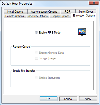

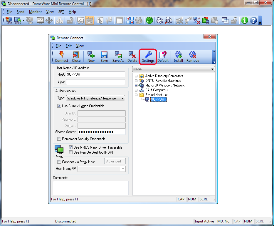

    1. FIPS mode can be enabled by selecting the Host Entry, then clicking on Settings.
    2. Select the Encryption Options tab and check the Use FIPS Mode checkbox.
    1. Click OK to save the settings for this Host Entry.

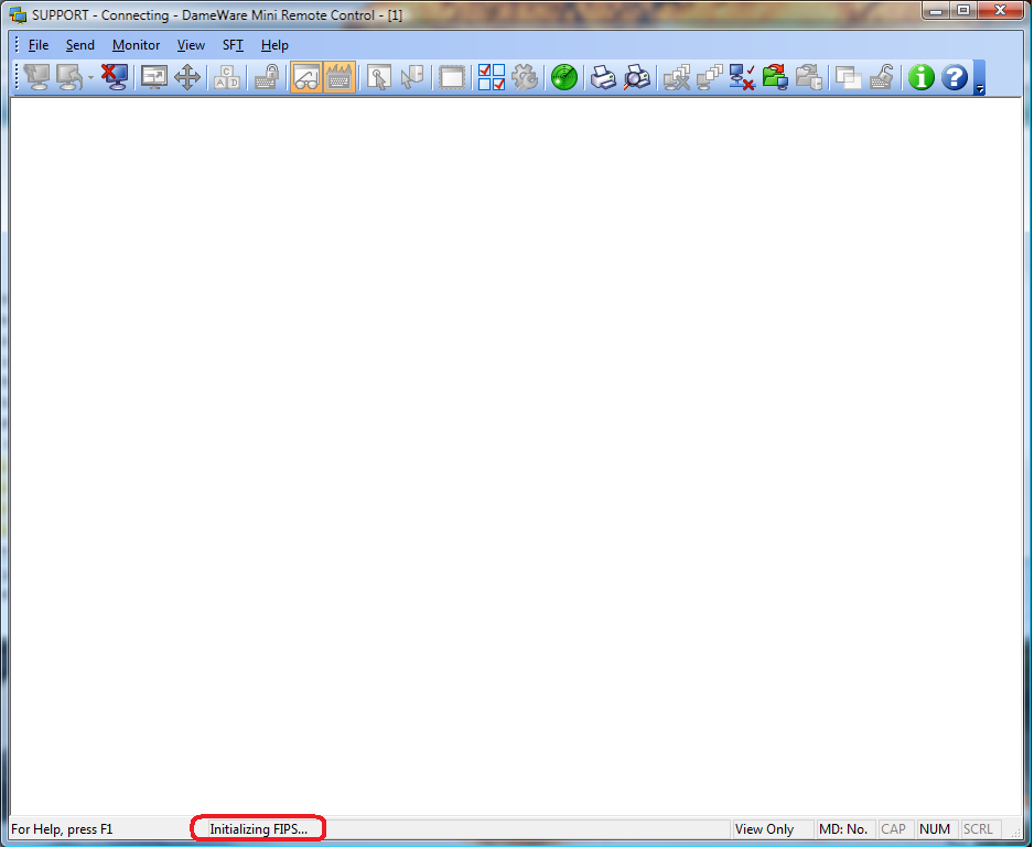

      Now a connection to the remote machine can be made in FIPS mode.
    2. Click Connect on the Remote Connect dialog.

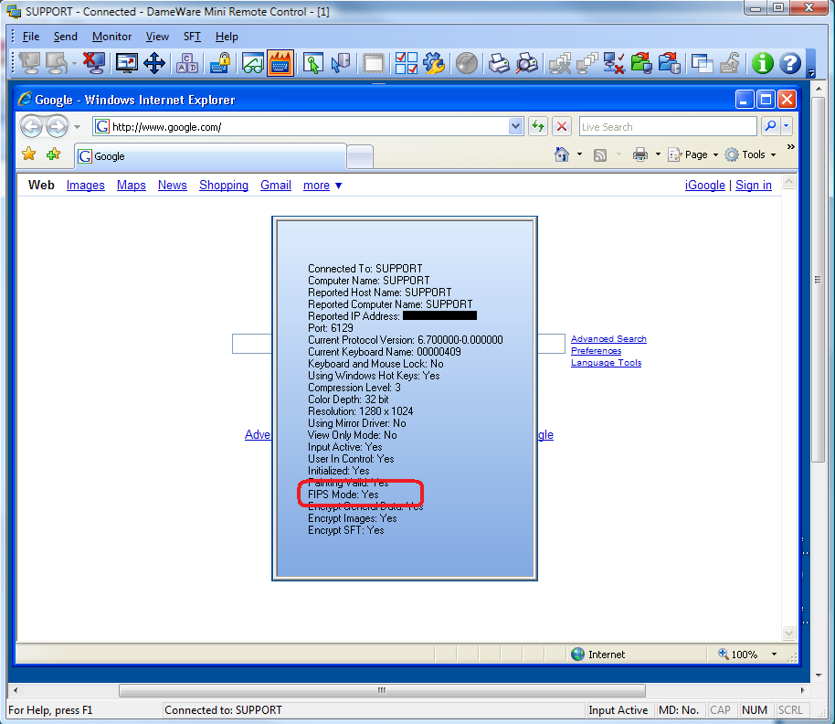

      Note the initialization of the FIPS mode libraries (on the Status Bar). Once completed, a FIPS mode connection is established.

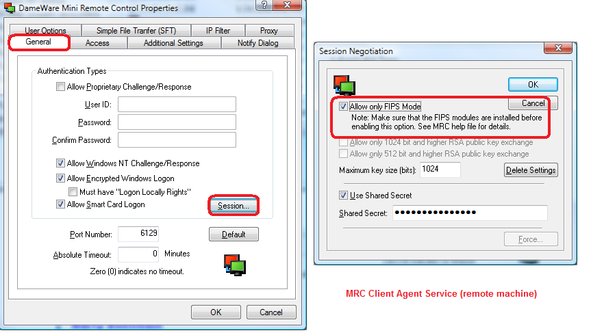

    How to enforce FIPS Mode in Dameware MRC:
    There are additional options within the Dameware MRC Client Agent Service on the remote machine to force every connection to this machine to use all encryption options within the Dameware MRC program.
    Within the properties of the Dameware MRC Client Agent Service, select the General tab, then click Session to open the Session Negotiation settings. By enabling the FIPS Mode option within the Dameware MRC Client Agent Service, even if users forget to enable the additional Encryption Options, the Dameware MRC software will automatically enable FIPS Mode encryption over this Dameware MRC connection.
