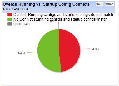

The following results appear when viewing Overall Running vs. Startup Configs Conflicts in NCM: Conflict: Running configs and startup configs do not match

When viewing the NCM Summary page, The following results appear when checking the Overall Running vs. Startup Configs Conflicts chart:

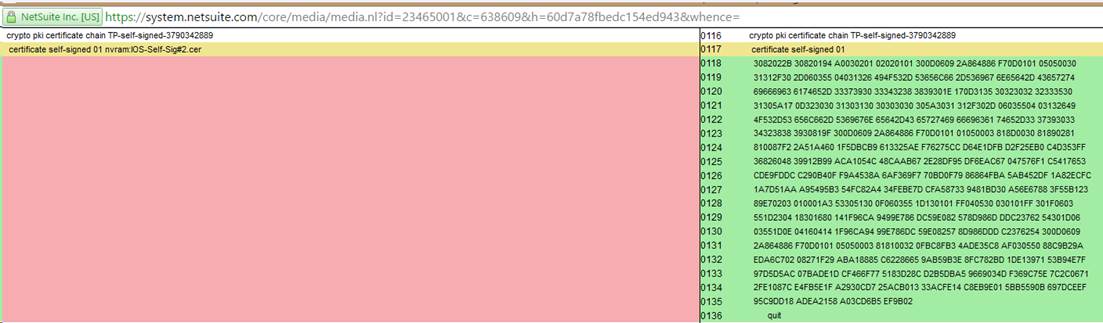

This occurs when devices highlight certificate lines in config comparison.
