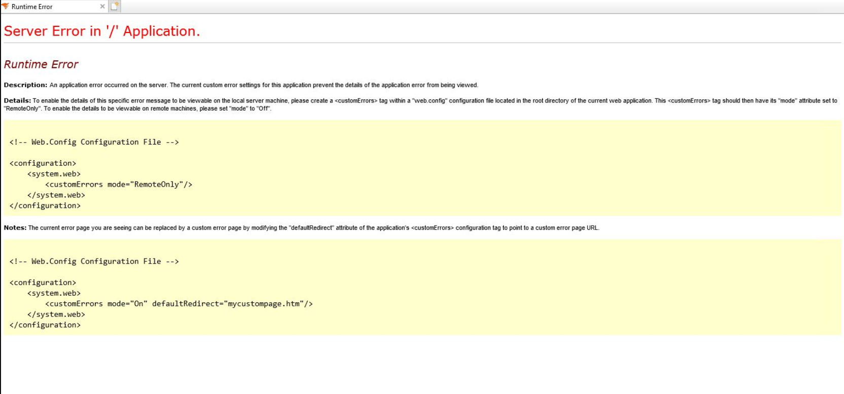

It will also present with an ERROR on the web console (in some cases):

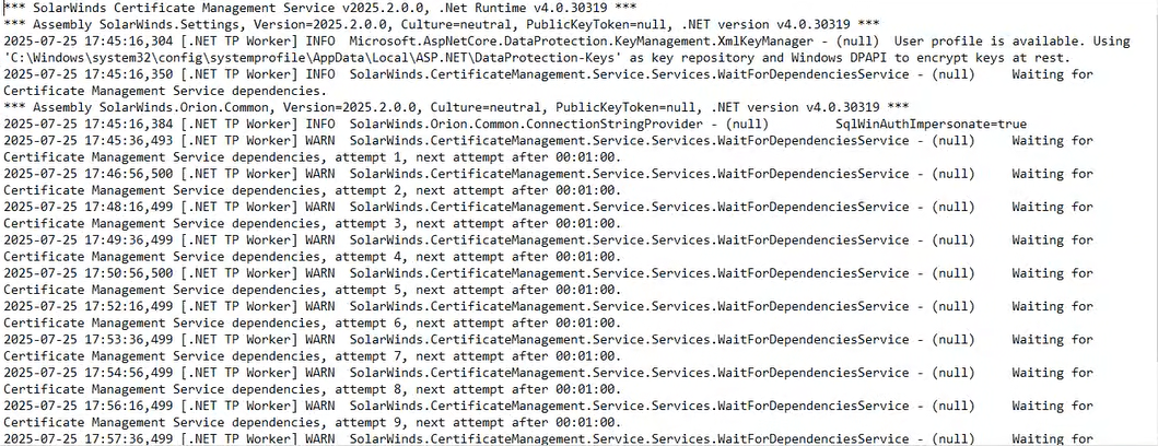

From the SolarWinds.CertificateManagementService.log:
With DEBUG logging enabled in SolarWinds.CertificateManagementService.log:
2025-06-27 12:22:09,095 [.NET TP Worker] DEBUG SolarWinds.CertificateManagement.Service.Services.WaitForDependenciesService - (null) Dependencies were not ready.
SolarWinds.Orion.Common.Impersonation.ImpersonationContext+CallbackException: Exception while running the action.
 ---> System.DllNotFoundException: Unable to load DLL 'Microsoft.Data.SqlClient.SNI.dll' or one of its dependencies: Access is denied. (0x80070005 (E_ACCESSDENIED))

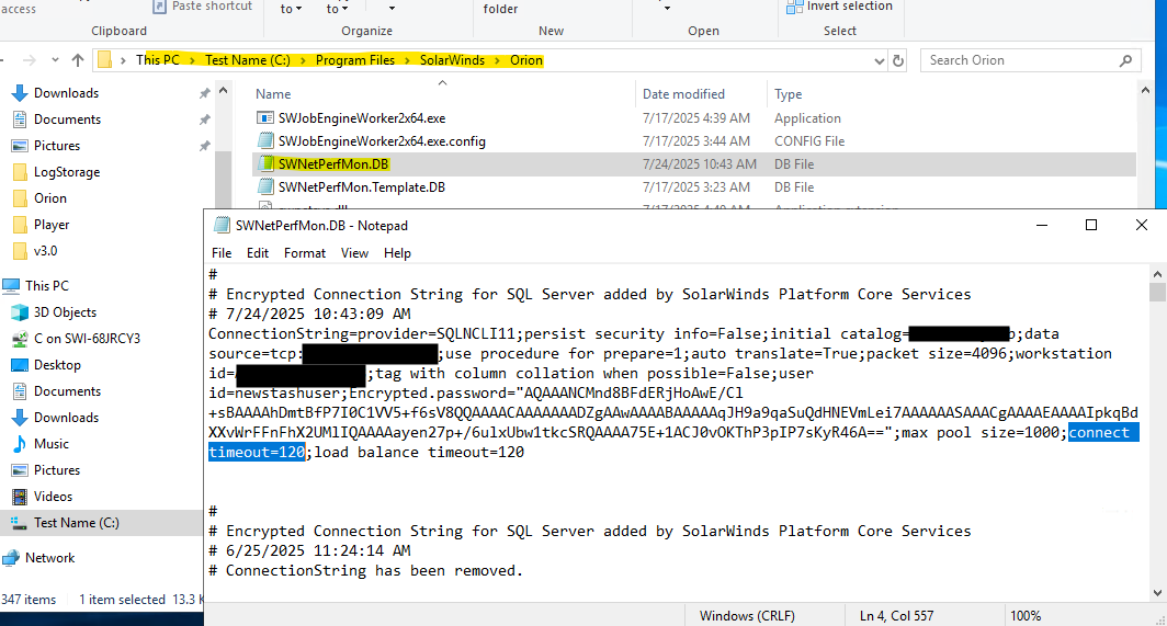

1) Navigate to C:\Program Files\SolarWinds\Orion -- Note this is the default install location; yours might be on a different drive
2) Find the swnetpefmon.db file and edit it with Notepad
3) In the first paragraph at the top of file will be the current connection string information. Towards the end of the paragraph, you should see a setting called connect timeout=20. Change this value to '120' and save the file.
4) Restart the SolarWinds services, and it should be able to connect now.
5) You can now rerun the configuration wizard to finish setup.
