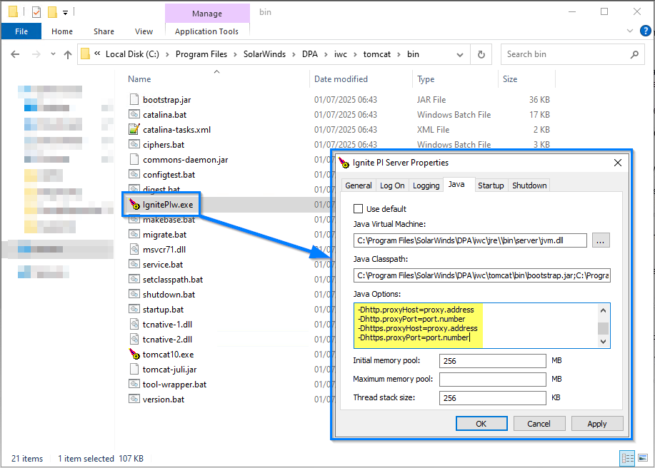

  1. Assuming the default installation path, navigate to:
  • C:\Program Files\SolarWinds\DPA\iwc\tomcat\bin\
  1. Open the 'Ignite PI Server Properties' tool, file called IgnitePIw.exe.
  2. Go to the 'Java' tab and add the following options at the end of the 'Java Options' text area:
-Dhttp.proxyHost=proxy.address
-Dhttp.proxyPort=port.number
-Dhttps.proxyHost=proxy.address
-Dhttps.proxyPort=port.number
  • If you are not using HTTP, Dhttp options can be skipped.
  • Changeproxy.address and port.number for the address and port of your proxy server.
  1. Click Apply and then OK to close the tool.
  2. Open services.msc and restart the 'Ignite PI Server' service.
