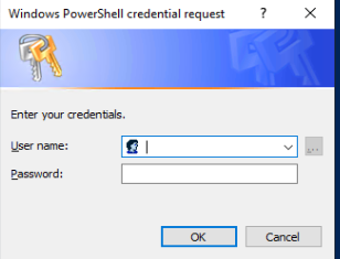

  2. Use Powershell to test if the email is possible with Basic Authentication:
    • Send-MailMessage -To '<recipient’s email address>' -From '<sender’s email address>' -Subject 'Your message subject' -Body 'Some important plain text!' -Credential (Get-Credential) -SmtpServer '<smtp server>' -Port 25
    • Input basic credentials from the window above.
    • A test email will be received if successful, and no error will appear on the PowerShell.
    • If there are errors, there is an SMTP issue on the SMTP server connection. Contact your SMTP admin or provider for support.
