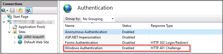

Part 2: IIS Configuration
  1. Open Internet Information Services (IIS) Manager on the web server.
  2. Navigate to: Sites → ARM Web API → Authentication, make sure "Windows Authentication" is enabled.
  3.  Right-click Windows Authentication → select Providers. Confirm the providers are listed as:
    • Negotiate
    • NTLM

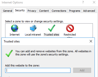

For Microsoft Edge and Google Chrome
  1. In your web browser, go to Internet Options and add the page to Trusted sites.

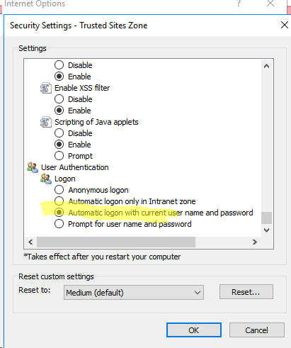

  2. Adjust the level so that the user can automatically log in with the current username and password.

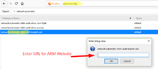

For Mozilla Firefox
  1. In the URL address bar, enter: about:config
  2. Search for network.automatic-ntlm-auth.trusted-urls
  3. Enter the address for your web application.
