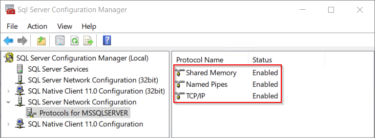

  3. Please make sure the following configurations are set:
SQL Server Configuration Manager configuration
(Screenshots property of © 2021 Microsoft)

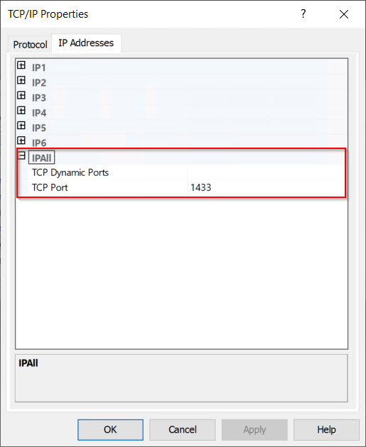

  1. In TCP/IP Properties make sure the TCP Port is specified and that TCP Dynamic Ports is empty as shown in this screenshot:
TCP/IP Properties - IPAll configuration
Note: The port from this screenshot is the default port, it can be changed to the preferred port.

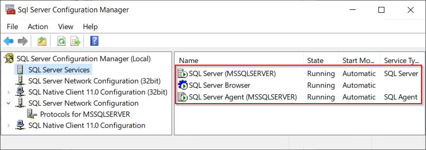

  1. After saving the configuration you will need to restart the running services listed in SQL Server Configuration Manager
SQL Server Configuration Manager restart the SQL services

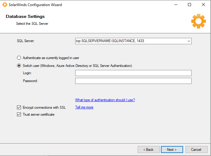

After these steps have been performed on your Orion application servers execute the Configuration Wizard.
Note: If SQL Server Browser service is not running on the SQL Server you will need to specify the port used while running the Configuration Wizard, please check the following screenshot as an example:
