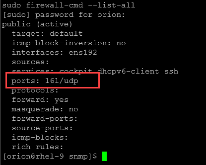

b. Check on firewall to see if port 161/udp is added, sample screenshot should show the port.
firewall-cmd --list-all
