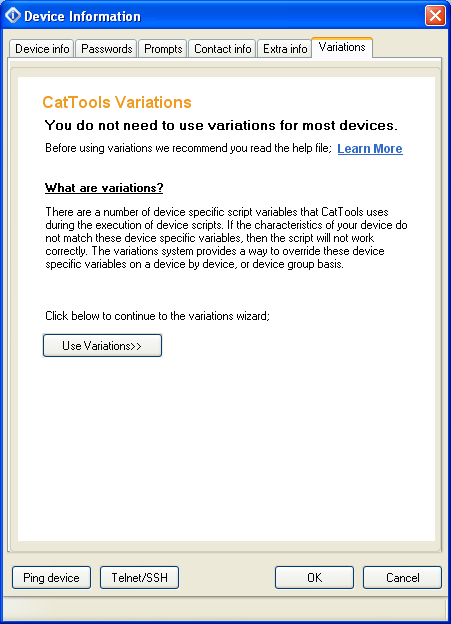

  1. Open CatTools Manager > Devices.
  2. Double-click on the required device and then click Variations.
  3. On the Device Information dialogue box, click Use Variations.

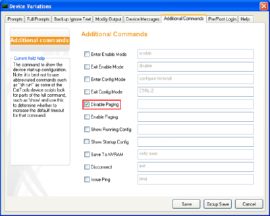

  1. On the Device Variations dialogue box, click the Additional Commands tab.
  2. Select the Disable Paging check box but leave the value blank, and then click Save.
