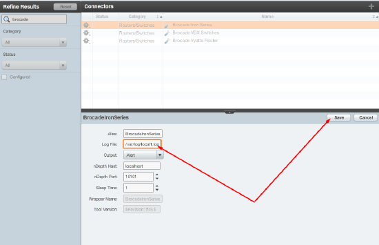

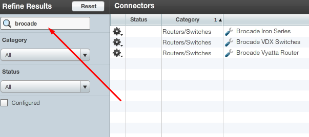

In the Flash-based SEM console:
  1. Log in to the SEM console.
  2. On the SEM menu bar, navigate to Manage > Appliances.
  3. Next to the SEM manager, click the gear icon, and then select Connectors.
  4. In the Connector Configuration window, enter Brocade in the search box at the top of the Refine Results pane.
  5. Next to the Brocade Connector you are trying to configure, click the gear icon, and then select New. Ensure the Log file location is set to /var/log/local1 (shown below as an example).
  6. Click Save.
    Note: local1 is based on what you configured in the first section above in your Brocade Switch/Router.
  7. Next to the newly configured connector, click the gear icon, and then select Start.

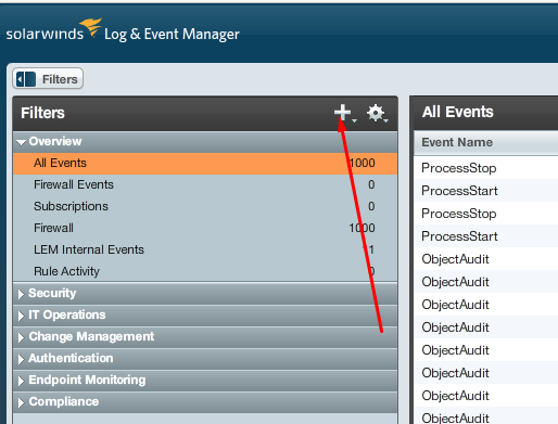

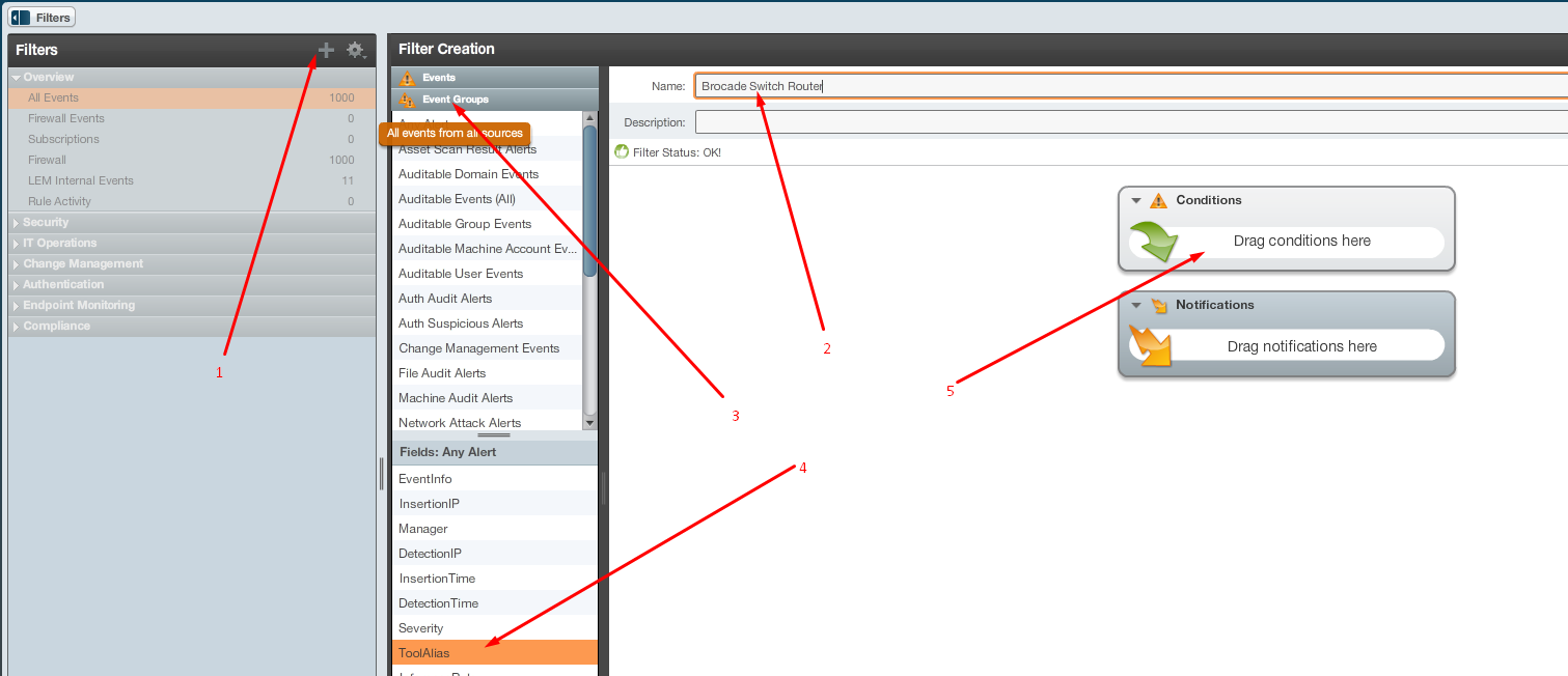

  1. In the SEM Events Console, click the Events tab.
  2. To create a filter at the root level, click the add  icon, and then select Add New Filter.
  3. Enter a descriptive name for your new filter (For example, Brocade Switch Router).
  4. In the Filter Values drag panel, expand Event Groups, and then select Any Alert.
  5. Under Any Alert fields, drag ToolAlias into the filter builder.
  6. Add your ToolAlias value, and then click Save. To find the ToolAlias value, select an applicable Brocade event log. In the Detail pane on the right, scroll down to ToolAlias.

  1. On the SEM console toolbar, click the Monitor tab.
  2. On the upper right of the Filters pane, click Create (big + sign on the left) > New Filter.
  3. Enter a name for the filter, such as Brocade switch and router.
  4. In the filters and groups list, click Event Groups > Any Alert, and then drag Tool Alias underneath the Conditions box to the right as shown below.
  5. On the lower right, click save.
