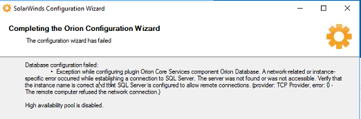

After running the SolarWinds Platform online installer, the Configuration wizard fails with an SQL exception.

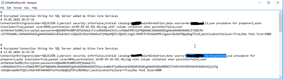

  • Every time the Configuration wizard runs, it adds a new connection entry to the SWNetPerfMon.db file.
  • The source only states the SQL server name (not the SQL server name/instance as is required).
Configuration error that occurred after running the SolarWinds Orion online installer:
ERROR Configuration Progress Scene - Exception while configuring plugin Orion Core Services component Orion Database>. System.Data.SqlClient.SqlException (0x80131904): A network-related or instance-specific error occurred

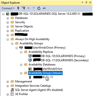

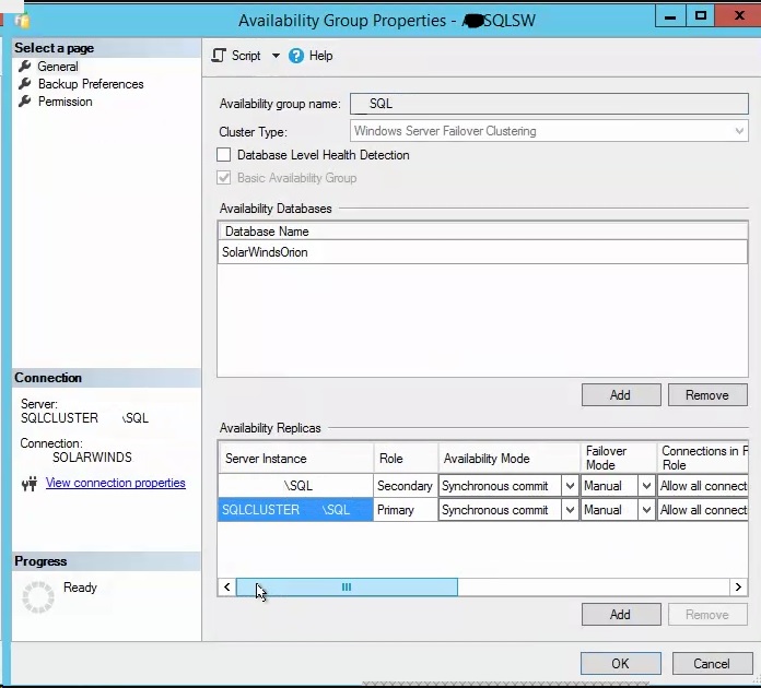

  • You are using Basic AlwaysOn on your SQL server, and the AlwaysOn listener has a named instance, for example: mylistener\myinstance. The Configuration wizard strips the instance and fails.
  • Your SolarWinds Platform product is having issues because you are using SQL AlwaysOn with no instance, but only a server name.
As a result, the file C:\Program Files (x86)\SolarWinds\Orion\SWNetPerfmon.DB is incorrect
because there are no users with Named Instance on the listener. It's not common nor expected.
SQL Setup in SQL Mgmt Studio
In the SWNetPerfmon.db file:

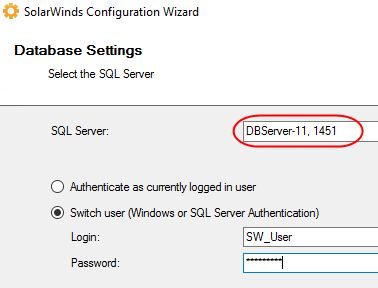

To resolve the issue:
  1. Run the Configuration wizard.
  2. In the Database Settings, use "mylistener,port" as the SQL Server if the port is unique for every instance on the listener.
The Configuration wizard now completes successfully.
You can also specify the SQL AlwaysOn port in the SWNetPerfMon.db file:
  1. Open C:\Program Files (x86)\SolarWinds\Orion\SWNetPerfmon.DB in a text editor.
  2. Specify the following as the Instance Name:  [ServerName], [SQLalwaysOnPort]
    Example: DBServer-11, 1451
The database file will remain correct and you can run the Configuration wizard on any polling engines.
