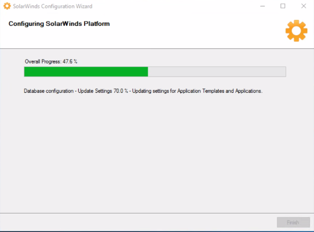

While upgrading the SolarWinds Platform, the Configuration Wizard gets stuck at "Updating settings for Application Templates and Applications":
Core_Configuration_Wizard_Updating_Settings_for_Application_Templates_and_Applications.png
