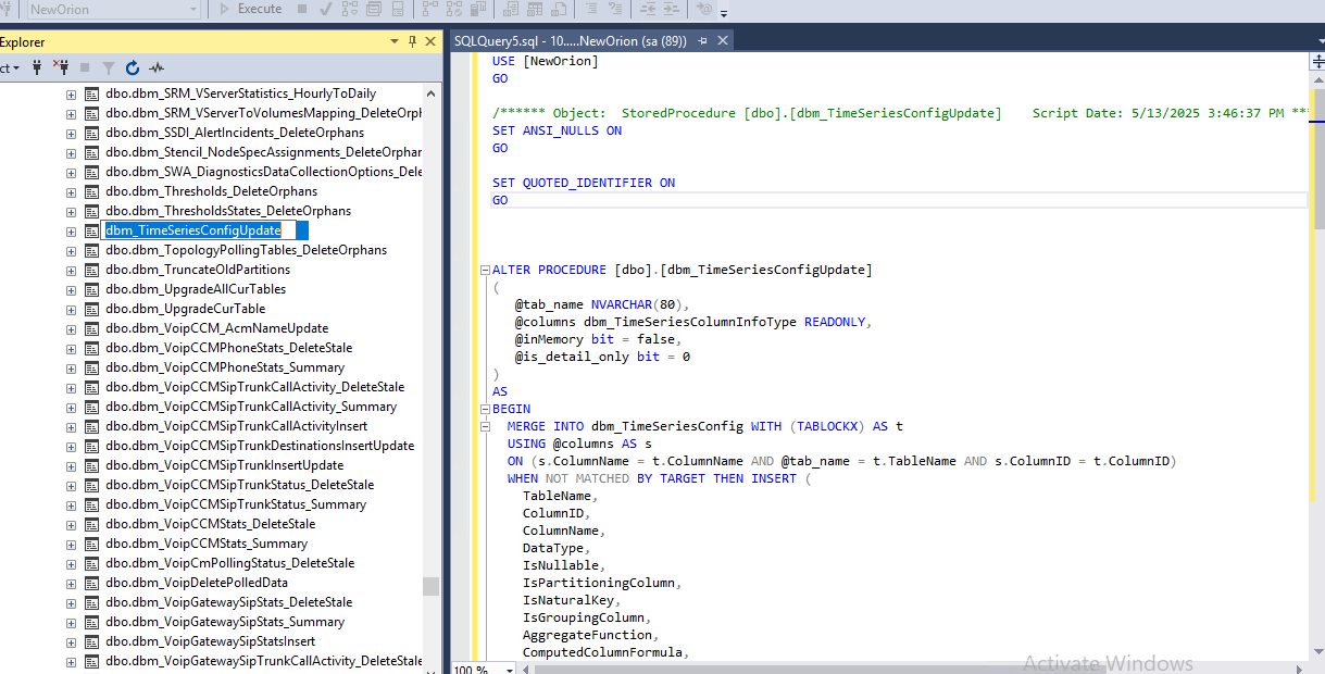

  1. Open SQL Server Management Studio and connect to the SolarWinds Platform SQL instance with admin credentials.
  2. Expand the SQL instance, right-click the SolarWindsOrion database, and select New Query.
  3. Paste the below query in the query window on the right and click Execute.
-- production or delivery of the scripts be liable for any damages whatsoever
-- out of the use of or inability to use the scripts or documentation
USE [SolarWindsOrion]
GO

  1. Run the Configuration Wizard, and it will complete with no errors.

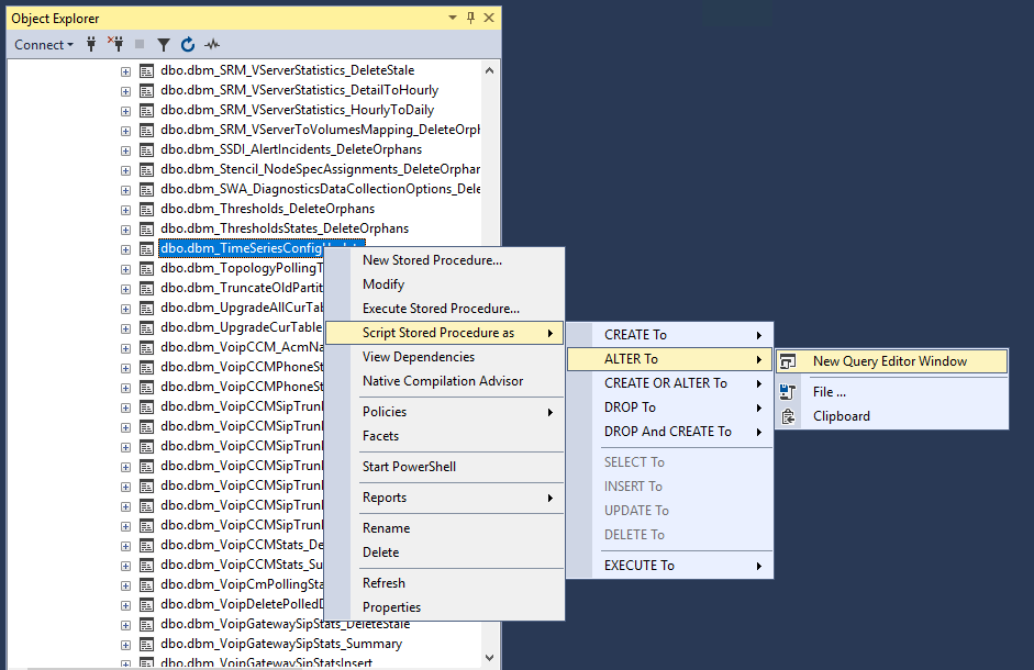

NOTE; You will need to generate the SQL query using the SQL Server Management Studio with the same version. Follow the steps below when generating the SQL Query.
  2. Expand the SQL instance and the SolarWinds Orion Database.
  3. Scroll down and expand Programmability.
  4. Expand Stored Procedures.
  5. Scroll down and look for dbo.dbm_TimeSeriesConfigUpdate.
  6. Right-click on dbo.dbm_TimeSeriesConfigUpdate --> select Script Stored Procedure as --> Alter To -- > New Query Editor Window.
  1. Copy the SQL Query and share it with your DBA.
