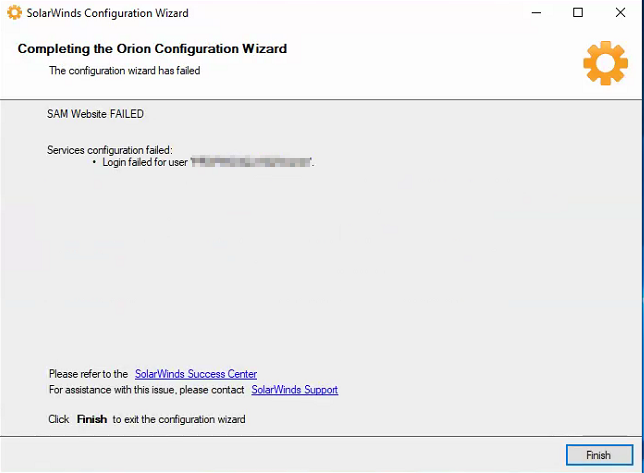

Running the Configuration Wizard hits a failure similar below:
ERROR seen in the ConfigurationWizard.log (C:\ProgramData\SolarWinds\Logs\Orion):
ERROR TaskAdapter - Error running task APM.ConfigureWebsite SAM Website
System.Data.SqlClient.SqlException (0x80131904): Login failed for user 'hostname\user_admin_account'.

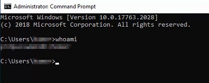

Confirmed via the command prompt that the logged-in user is a Local Administrator Account:
