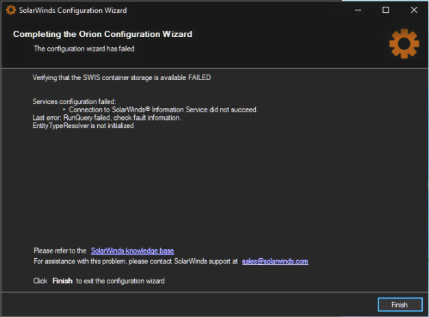

When you run the Configuration Wizard, the wizard fails with the following error:
Verifying that the SWIS container storage is available FAILED
Service configuration failed:
Connection to Solarwinds Information Service did not succeed.
Last error: RunQuery failed, check fault information.
EntityTypeResolver is not initialized
Sample Image:

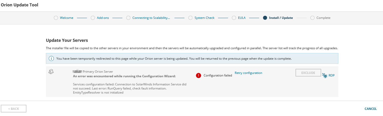

This can also be encountered while running an upgrade via Centralized Deployment:
