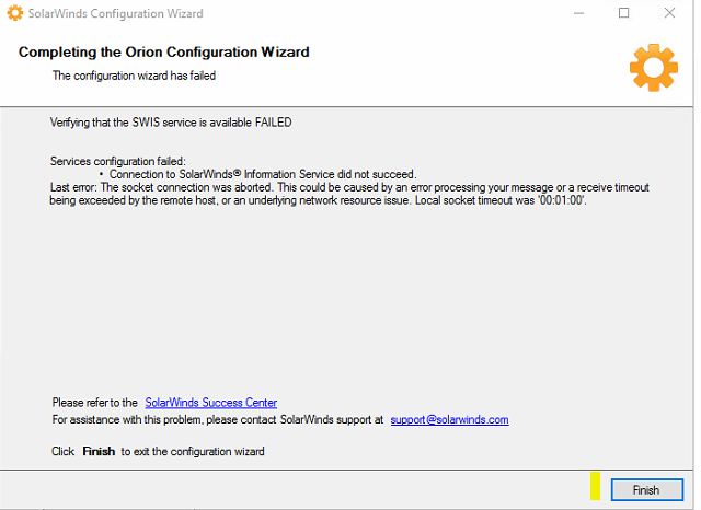

When you run the Configuration Wizard, the wizard fails with the following error:
Error Message:
Service configuration failed:
Connection to SolarWinds Information Service did not succeed.
Last error: The socket connection was aborted. This could be caused by an error
processing your message or a receive timeout being exceeded by the remote host, or an
underlying network resource issue. Local socket timeout was '00:01:00.
Sample Image:

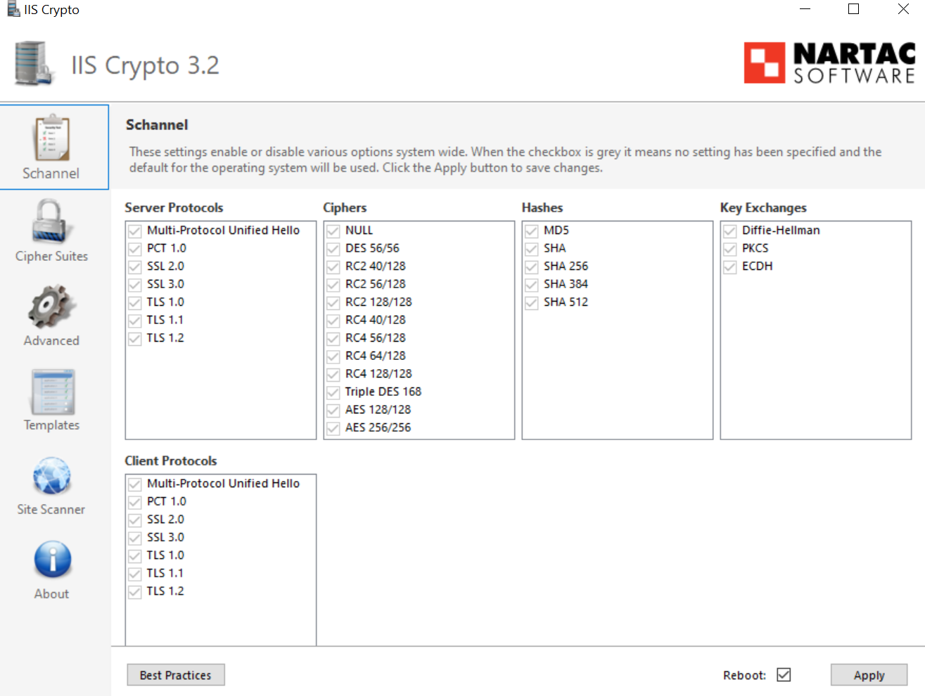

TLS is not enabled.
  • Run IIS Crypto on Orion Server.
  • Click Best Practices.
  • Check Reboot.
  • Click Apply.
  • After rebooting the Orion Server, run Configuration Wizard.
