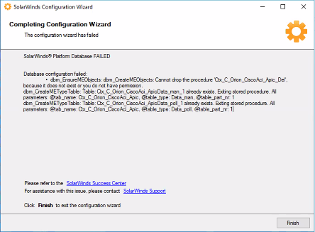

When running the Configuration Wizard, it fails with an error similar to the following:
Database configuration failed:
  dbm_EnsureMEObjects: dbm_CreateMEObjects: Cannot drop the procedure 'Ctx_C_Orion_CiscoAci_Apic_Del',
  because it does not exist or you do not have permission.
  dbm_CreateMETypeTable: Table: Ctx_C_Orion_CiscoAci_ApicData_man_1 already exists.
  Exiting stored procedure.
  All parameters: @tab_name: Ctx_C_Orion_CiscoAci_Apic, @table_type: Data_man, @table_part_nr: 1
  dbm_CreateMETypeTable: Table: Ctx_C_Orion_CiscoAci_ApicData_poll_1 already exists.
  All parameters: @tab_name: Ctx_C_Orion_CiscoAci_Apic, @table_type: Data_poll, @table_part_nr: 1
This error can be found in the Configuration Wizard log at: C:\ProgramData\SolarWinds\Logs\Orion\ConfigurationWizard.log
