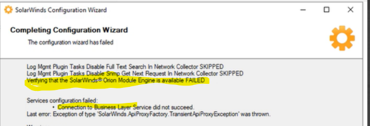

This article discusses an issue where the SolarWinds Configuration Wizard fails at “Verifying that the SolarWinds Orion Module Engine is available FAILED” and “Connection to Business Layer Service did not succeed. Last error: Exception of type ‘SolarWinds.ApiProxyFactory.TransientApiProxyException’ was thrown.”
From Business Layer Host log:
2026-03-16 15:44:41,090 [8] FATAL SolarWinds.BusinessLayerHost.BusinessLayerHostService - Failed to initialize: System.Exception: Failed to retrieve features from Feature Service: The requested security protocol is not supported. ---> System.NotSupportedException: The requested security protocol is not supported.
at System.Net.Http.HttpClientHandler.SecurityProtocol.ThrowOnNotAllowed(SslProtocols protocols, Boolean allowNone)
Network Performance Monitor
Feature Service gRPC client is attempting to use an unsupported TLS protocol (for example SSL 3.0) as defined in the SolarWinds SecurityProtocols settings and/or Windows SChannel. This causes a System.NotSupportedException: The requested security protocol is not supported. in GrpcWebClientWithCertificateManagementFactory, prevents Business Layer from retrieving features, and stops the Business Layer Host from initializing.

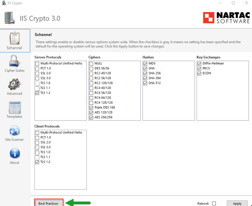

Alternative Tool
  1. Log in to the computer hosting SolarWinds Platform Server as an administrator.
  2. Download and install IIS Crypto from Nartac.
  3. Open the tool.
  4. Click on Best Practices
  5. Make sure TLS 1.2 is only enabled in Server and Client
  6. Reboot the server
  7. Repeat steps 3-7 on all SolarWinds servers (on the HA backup of the main polling server if available, then on any additional polling servers, additional web servers, and any other HA servers).
