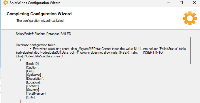

Scenario 1
C:\ProgramData\SolarWinds\Logs\Orion\ConfigurationWizard.log
2026-10-23 02:27:43,171 [5] ERROR TaskAdapter - Error running task Orion.ConfigureDatabase SolarWinds Platform Database
SolarWinds.ConfigurationWizard.Common.ConfigurationException: Error while executing script- dbm_MigrateMEData: Cannot insert the value NULL into column 'PolledStatus', table 'nullvaluetest.dbo.NodesDataSplitData_poll_4'; column does not allow nulls. INSERT fails.

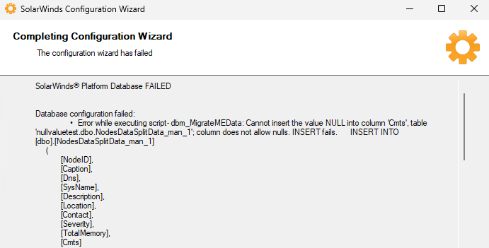

Scenario 2
2026-10-23 02:38:16,449 [3] ERROR TaskAdapter - Error running task Orion.ConfigureDatabase SolarWinds Platform Database
SolarWinds.ConfigurationWizard.Common.ConfigurationException: Error while executing script- dbm_MigrateMEData: Cannot insert the value NULL into column 'Cmts', table 'nullvaluetest.dbo.NodesDataSplitData_man_1'; column does not allow nulls. INSERT fails.

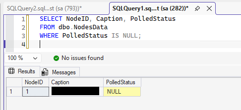

NULL values in the source columns in the NodesData table are causing the table migration to fail. You can see an example of the NULL values in the affected columns below. You may have multiple records with NULL values.
Scenario 1

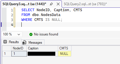

Scenario 2

1.) Identify Nodes with NULL values to fix
Run the queries below; if any return rows with NULL values, use the corresponding query in step 2 to update them to a valid value.
  • Check for NULL values in the 'PolledStatus' column
SELECT NodeID, Caption, PolledStatus
FROM dbo.NodesData
WHERE PolledStatus IS NULL;
  • Check for NULL values in the 'CMTS' column
SELECT NodeID, Caption, CMTS
FROM dbo.NodesData
WHERE CMTS IS NULL;
