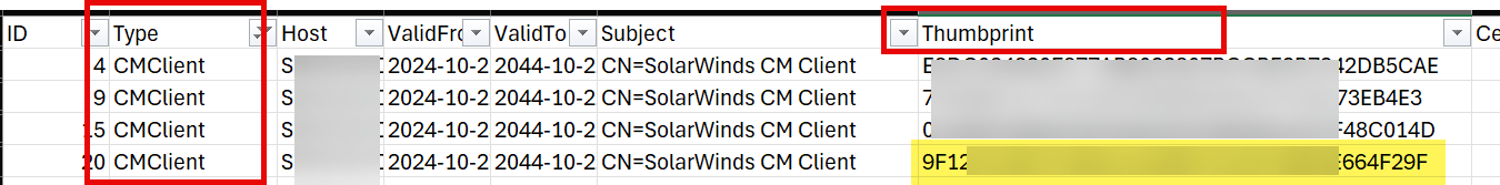

  • Check for the CM client certificates on the certificate table via Database Manager:
  • Once confirmed, go to Certificate store (mmc.exe)  and match the certificate assigned on the Main Poller. Check the thumbprint of CM Client certificates available in the certificate store.
  • If multiple SolarWinds CM client certificates are found, remove the other CM client certificates that do not match the certificate thumbprint assigned to the Poller.

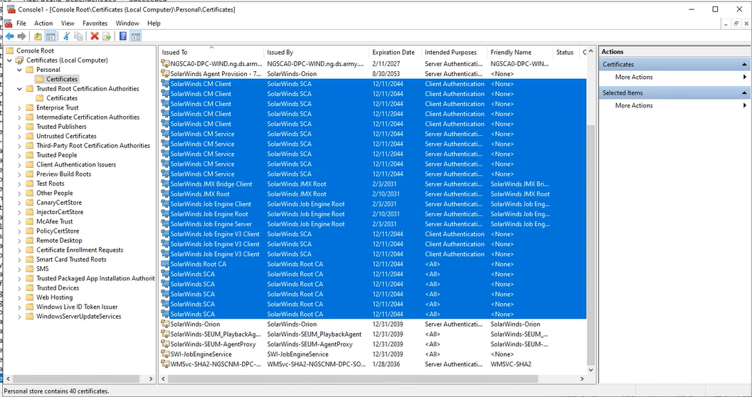

  • If the issue persists after deleting the duplicate certificate without the related thumbprint in MMC, you may proceed with deleting all SolarWinds certificates within MMC.
    After completing the certificate cleanup, re-run the Configuration Wizard.
    Ensure that only the SolarWinds-related certificates are removed.
     Example:
