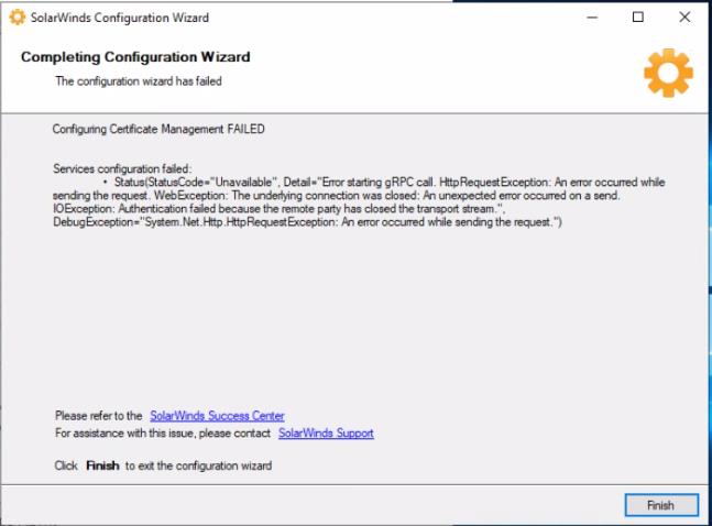

Configuration Wizard Error related to Certificate Management Service:
Configuration Wizard Failed - Configuring Management Certificate FAILED
Services configuration failed:
Status (StatusCode="Unavailable".Details="Error starting gRPC call HttpRequestException: An error occurred while sending the request. WebException: The underlying connection was closed: An unexpected error occurred on a send.
IOException: Authentication failed because the remote party has closed the transport stream.".,
DebugException="System.Net.Http.HttpRequestException: An error occurred while sending the request.")

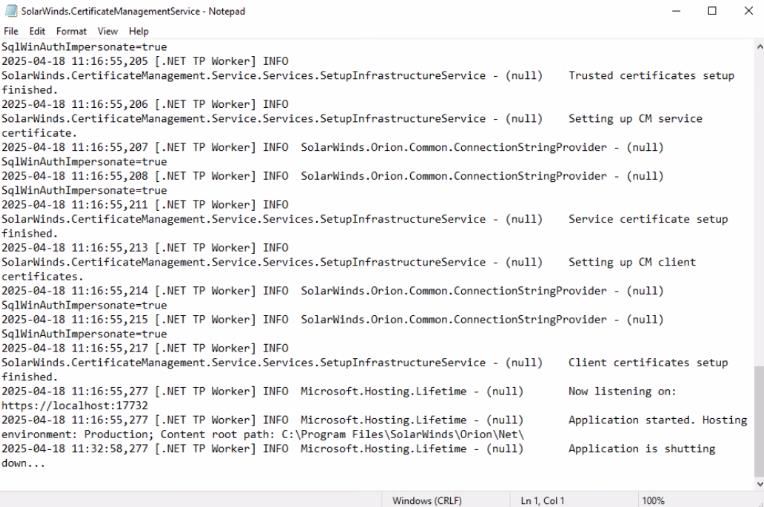

Solarwinds Certificate Manager shows no issues as seen on this screenshot:

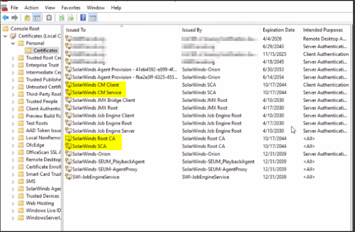

The cause of the issue is related to Solarwinds CM Client, Solarwinds CM Service, Solarwinds Root CA, and Solarwinds SCA Certificate that is currently added under Certificates\Personal. in Microsoft Certificate Manager:
Solarwinds Certificates
Have Solarwinds Services stopped, especially the Solarwinds Certificate Manager. Remove the following certificates in the affected poller and then run the Configuration Wizard:
  • Solarwinds SCA
  • Solarwinds Root CA
  • Solarwinds CM Client
  • Solarwinds CM Services
