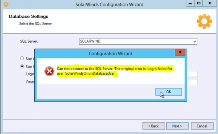

The following error appears when running the Configuration Wizard:
Can not connect to the SQL Server. The Original error is: Logon failed for user 'SolarWindsOrionDatabaseUser'
Orion Platform
This issue occurs when:
  1. The SQL user '<username>' password was manually changed in the SQL server
  2. Trying to connect with an incorrect password

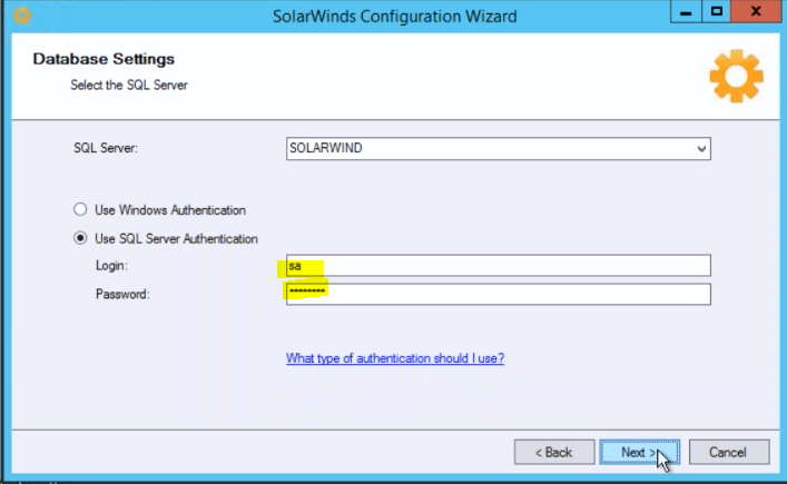

If the password was manually changed on the SQL server, enter the new password for the SQL user using the configuration wizard.  If this does not resolve the issue, perform the following steps below:
  1. Check to make sure SQL server is set to mixed authentication especially on new installs.

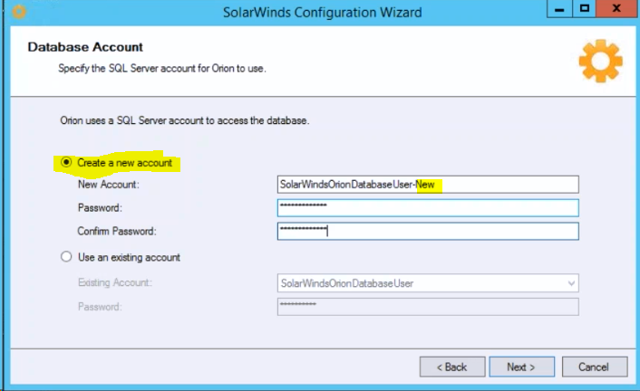

  2. Use the SA (SQL Administrator) user name and password to connect to the SQL server and then can create a new DB user account/password for the Orion:
